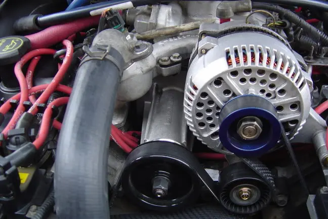

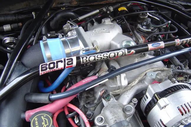

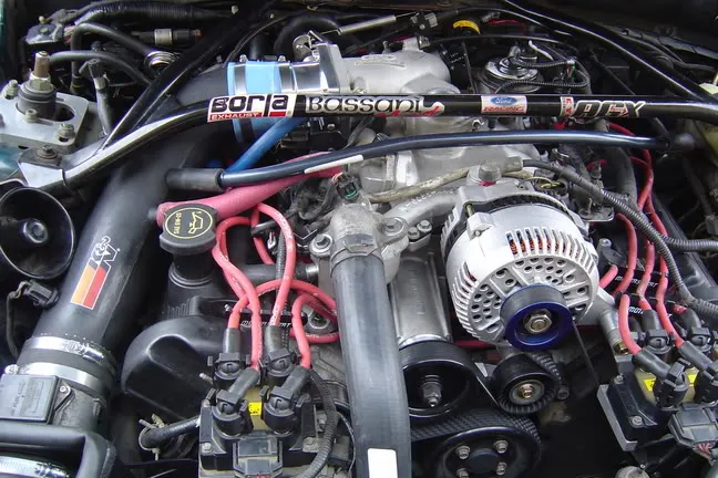

Here are some pics:

That is a very sweet setup. :nice:
