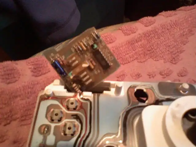

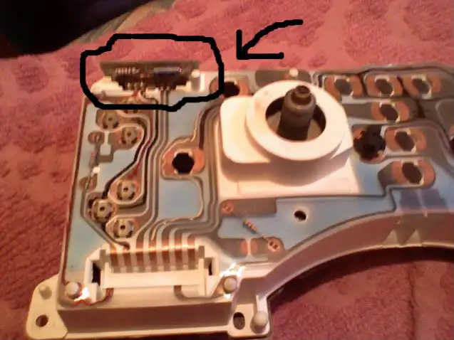

This is the anti slosh module on the back of the cluster.
I seen them at 50resto and at the junk yard of course.
ok but if that went bad then I should probably either get no reading at all, or a crazy fuel gauge...
