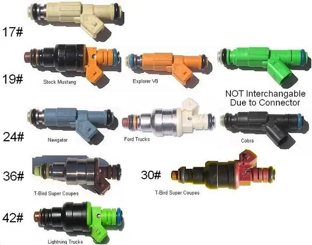

Guy Im trying to remember the colors of the ford fuel injector. Is this correct
Orange 19#
Blue 24#
Red 30# ?
I have not been around the 5.0 in a few years, trying to brush up, I bought my car with the blue injectors.
See the following website for some help from Tmoss (diagram designer) & Stang&2Birds (website host) for help on 88-95 wiring http://www.veryuseful.com/mustang/tech/engine/
http://www.veryuseful.com/mustang/tech/engine/images/Ford_Injector_Guide.jpg

ok guys thanks and jrichker thanks for the infor. I am a little intimidated by the wiring in the foxes. I am more familiar with the new edge cars and I am in the process of disconnecting the alarm on this car, so all info is helpfull.
