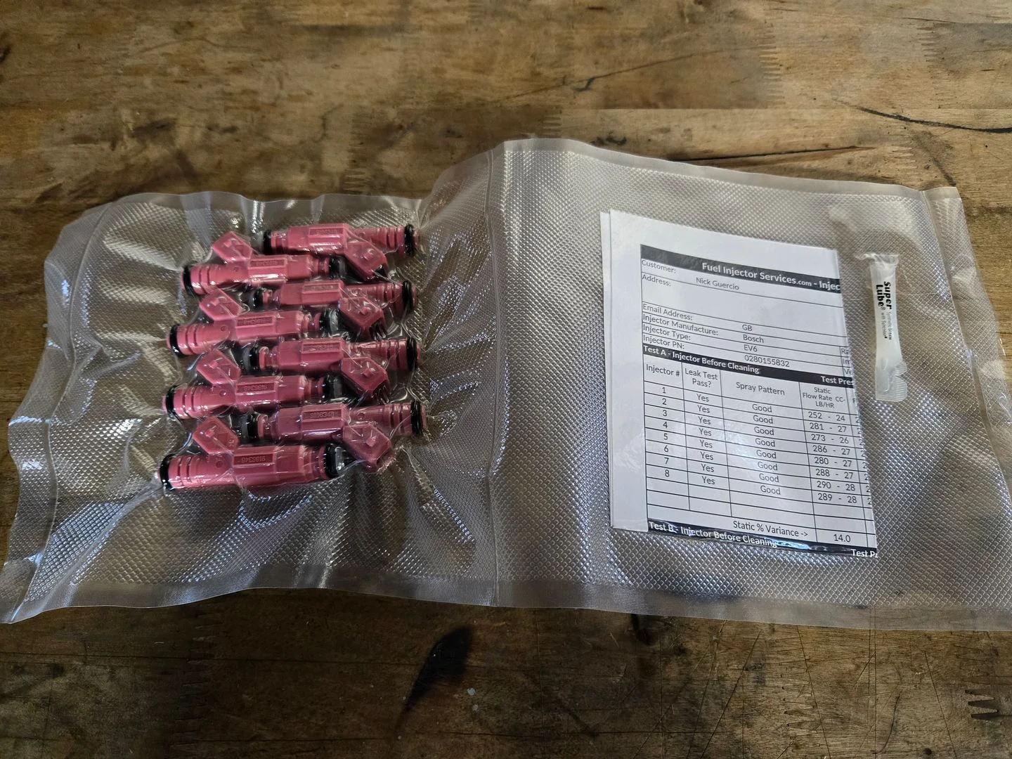

The first set of injectors I got from LMR. They are the pink 24lb injector. This pic taken after getting them back from flowtesting. (They shipped from LMR loose in a ziplock bag.)
I wasn't thrilled with the results.
The flows were pretty inconsistent with each other and one of them had a higher resistance. Had I not got them flow tested I would have never know. I definitely didn't have the warm and fuzzies about using them.

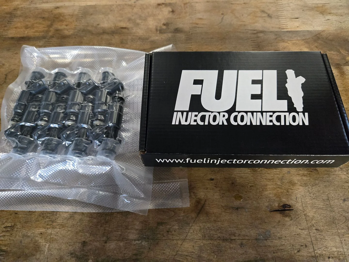

I asked the owner of the shop if he knew of a place where I could order a set of new, not re manufactured OEM quality injectors. He recommended Fuel Injector Connection. I gave them a call and I ordered a set of flow matched, new, authentic Bosch 24lb injectors. Again I took them to be flow tested.
This time the results were great. This is what I expected to see from a quality injector. They flow nearly identical.

The static test is when they open the injector and just let it flow for two minutes. Which would be similar to running it at 100% duty cycle. They were almost 15% apart from the lowest flowing injector to the highest. That seems significant.
The dynamic test is when they operate the injector at a duty cycle similar to normal driving. That test for the pink ones was almost 10% variance. Again it seems significant.
So if I happened to grab three of the highest flow injectors and the lowest flowing injector and put them all in the same bank I wouldn't expect it to work out very well.
The LMR ones seem solid at 43 psi but they sure lose consistency at 90. I wonder if that much pressure is outside of their specs?
Edit. Just saw how far off injector 1 is at 43 psi...still 24# but lower than the rest.
The flows report is a little odd to read. I should have mentioned more detail about how it's organized.
The flow is measured accurately in CC/minute (the first 3 digit #). Then converted to what lb/hr class it would represent in two digits with no decimals. The lb/hr is not the accurate number to use for any calculations. For example If you do a calculation you would see 268 CC/Min = 25.523809523809526. On the report it would be listed as 26 lb/hr because it's technically closer to 26 than 25.
cc/m to lb/hr calculator
-So the CC is the number to pay attention to and the number the variance percentage is based on.
-The variance % is the number to look at to see how closely they are matched as a group.
-The CC flow # would be what to use to see what each injector is flowing individually when deciding on individual placement in the rails.
So the pink ones at 43.5 psi have a 14% variance static and 9.6% variance dynamic. Oddly they actually flowed more evenly matched when pushed to 90 psi as that variance dropped to 5.9 / 6.5.
In contrast the flow matched set from Fuel Injector Connection measured 1.1% and 1.2% variance respectively for both 43.5 psi tests. Which is better by a wide margin.
I can't blame LMR. They are just selling someone else's product who tells them what they are rated at. I'd guess they have a big box of them and grab 8 per order. You get what you get. Someone else might get a better matched set. Or maybe a worse one. Its pretty much luck of the draw, literally. They are just a reseller.
Fuel Injector Connection is an injector specialist and flow matches each order in house. It's their business so I expected alot from them and they delivered a really nicely matched set.
