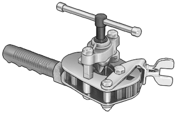

AN fittings require a 37 degree flaring tool. A standard automotive or household plumbing tool is 45 degrees and cannot be used with AN flare fittings. If you do, the flare is subjected to too much stress when the fitting is tightened, and is likely to fail or leak.
See http://www.mscdirect.com/ , http://www.mcmaster.com/ or for the flaring tool you will need . Prices start at $85 and go up
http://www1.mscdirect.com/CGI/N2DRVSH?PACACHE=000000013509163
http://www.mcmaster.com/#flaring-tools/=b4fxc3
Last time I was in Summit racing, they had a 37 degree flaring tool for less than $40. It may or may not be a catalog item.

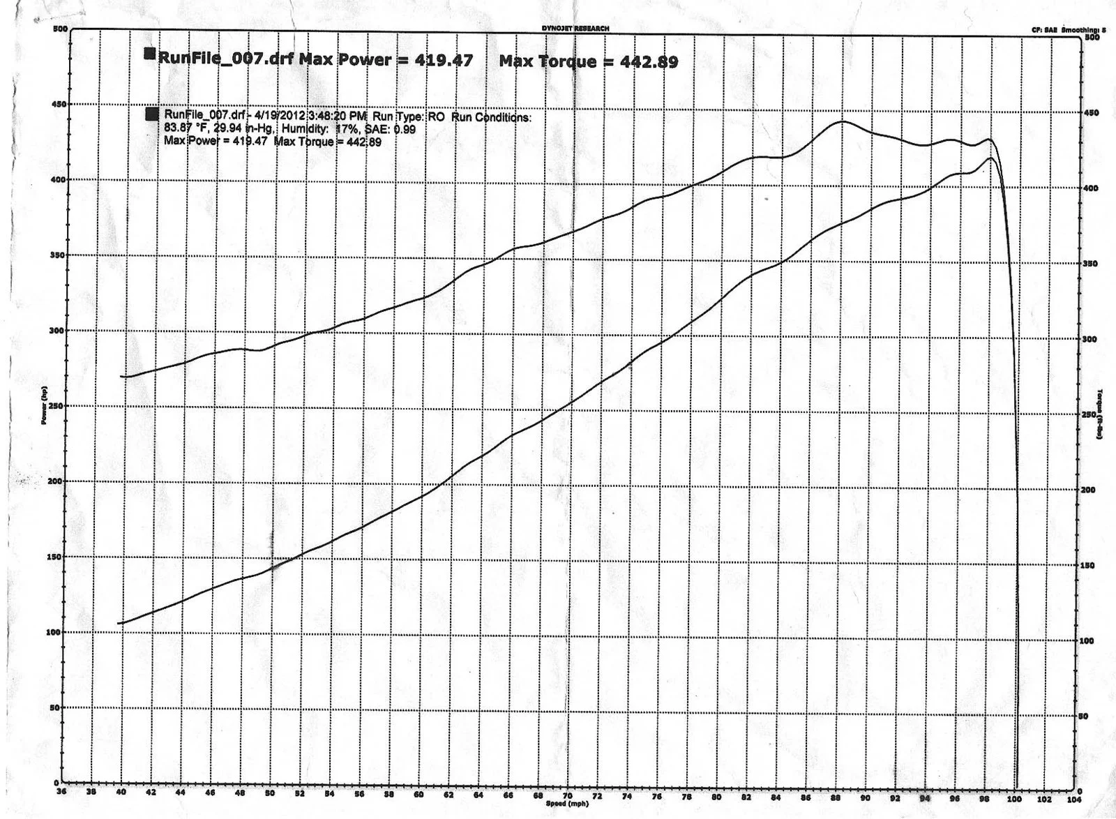

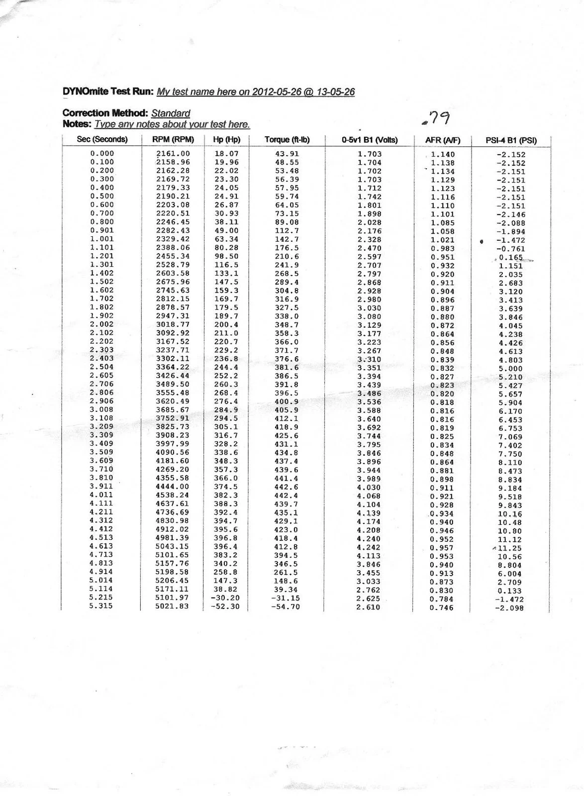

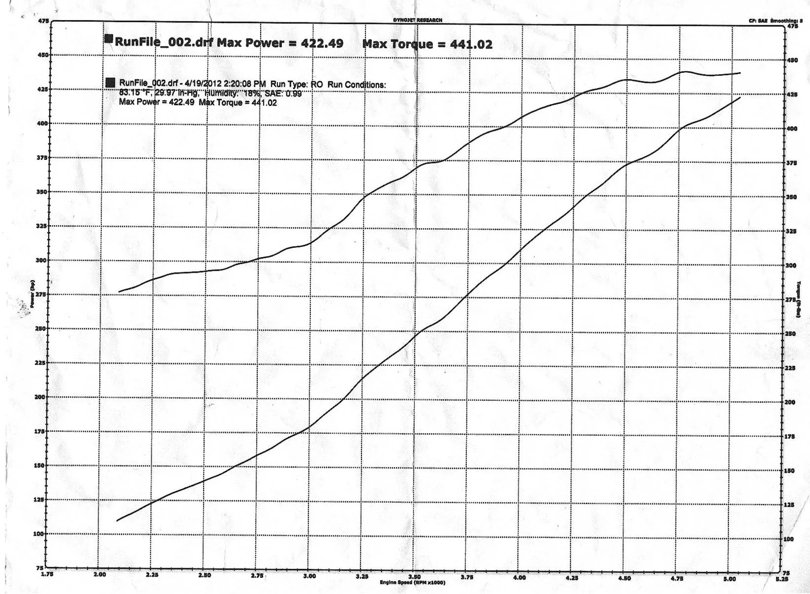

I've upgraded my fuel lines and rails & fuel pump to Aeromotive 340 (signature updated). All this had NO effect. Fuel still cuts out at around 420hp, 4000rpm, 100mph. Fuel injectors at 100%.
I have attached the best 2 dyno runs and as you can see, the graph falls at around 420hp at 100mph. The third the chart containing the volts, AFR & PSI was obtained from a 3rd tuner who was getting the same result.
According to the tuner's notes, adjustments to the fuel curve had no effect. Reason unknown. Vehicle runs out of fuel under boost. Fuel injectors are maxed out and there is still not enough fuel. The recommendation was to install larger fuel lines and rails which I did. The result was no effect.
I had first thought that the 9AL had something to do with the problem. But wouldn't the tuner see that this was the problem since he is connected directly to the computer?
This problem has got me baffled and I am out of ideas. Needless to say that I can no longer pump tons cash into this 20 year project. I need answers.
Judging by the graphs & the info given, can you help?

Ur out of fuel? Or ur tune is not right? What psi at high rpm? Has your tuner done a true flow test? We only run 39 lb inj off a wlb 255 and an msd BAP on the 2004 mac. With dyno tested 455 hp na and 700 hp with NOS. We have never ran out of fuel. On that note we are now having issues with the psi dropping but sup the wlb 255 is going out. I have herd that with the forced induction a BAP is a must cause as manafold pressure increases the amount of vac going to the reg that controls the fuel pump decreases and slows down the pump. We had this issue with ours even with it being NA. The Bap fixed the issue. Also what is the duty cycle of your pumps set at?
Your graphs are mostly unreadable.
To maintain rated fuel flow for injectors, you have to increase the fuel pressure 1 PSI of each PSI of boost.
Example: Injectors are rated at 60lb, at base fuel pressure of 40 PSI. You have 10 PSI boost. The effective fuel pressure is then 30 PSI. In order to get the same 60 lb fuel flow volume, you need to crank the fuel pressure up 10 PSI to 50 PSI.
