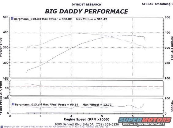

thanks for all of your posts. you guys all rule. i love that you can get on the internet and fellow car guys help eachother. that being said, i talked to my tuner and i need to make an appointment to verify the a/f ratio and such. he said that the fuel pressure should go up over 39 psi in a 1:1 ratio to boost at WOT. so at 10 psi of boost i should see 49 psi of fuel pressure. so we'll see whats up. the a/f was all good when it was tuned, but i had no FP gauge at the time.
ok so i took it to the dyno today. it ran pretty much the same numbers as last year. fuel pressure was up over 50 psi the whole time. look on the graph to see the fuel pressure throughout the run. my gauge still only reads 40 psi for some reason, but i know the pressure is more than that and that my air/fuel ratio is safe at 12.0 or less, it was at about 11.8 most of the time. does anyone have the gt supercar pump and 42 lb injectors and an auto meter fuel presure gauge? if so what does it read for you? heres the chart:
