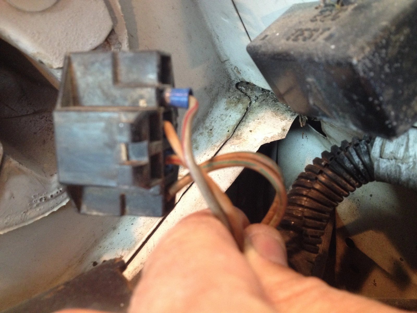

This is all garbled up. 2 brown/green stripe spliced together bottom right of 4pin side to the left is a brown/red, to left is solid brown, last on left is gray/red stripe. No wires in top 2 slots.

Theres no black/ white cpu test ground wire? Lol

Cant dump codes but amazing what happens when you set timing correctly!!!

the other port you need there is a single wire connector. Should be a few inches away coming from the same harness bundle. Find that.

1990 mustang Gt. No single connector? A 2pin connector comes off wiper motor to no where. But no single? Will get into loom tomorrow to see if it got cut or corroded.
