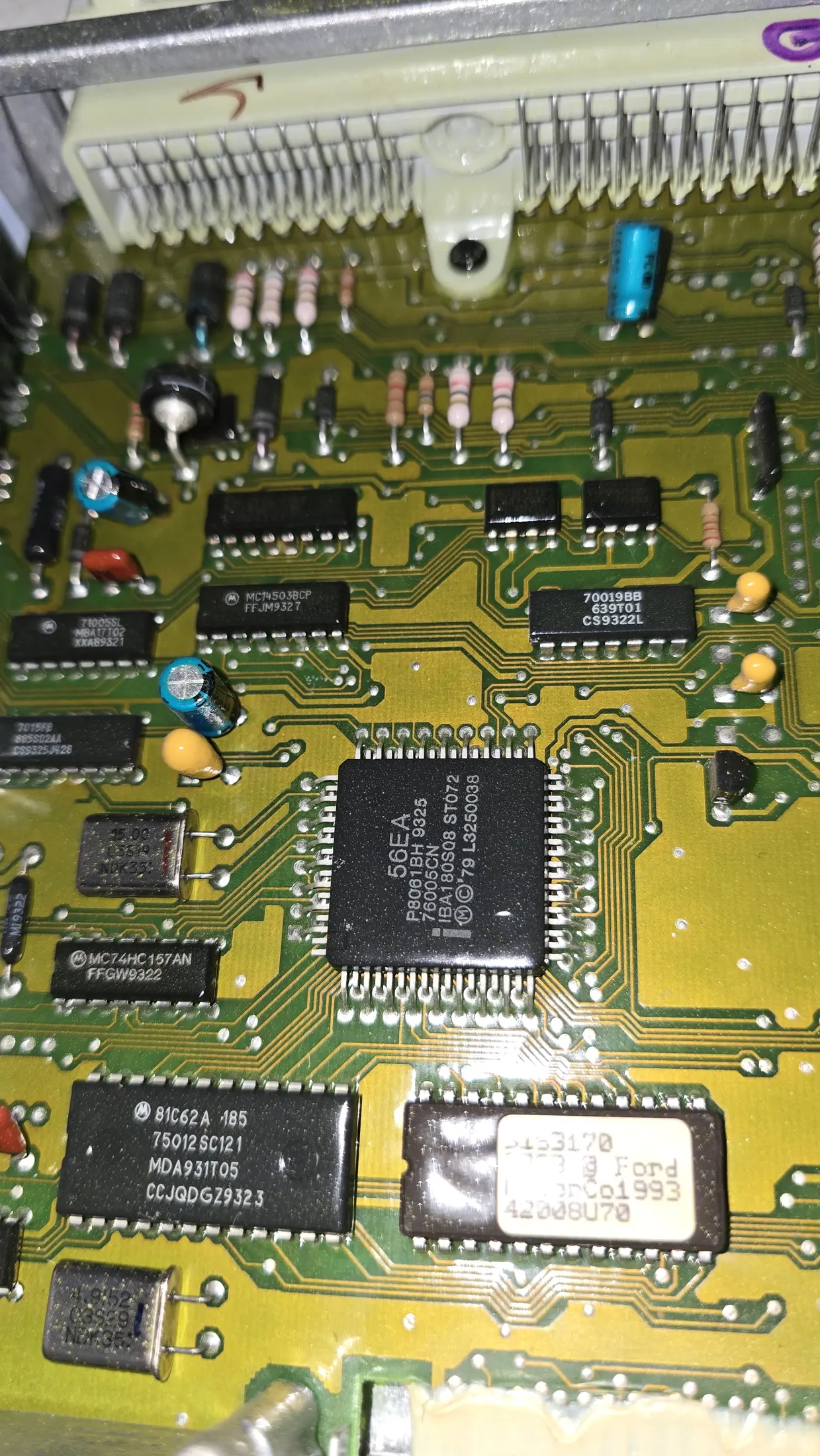

Generally, when the fuel pump stays running, you need to check the capacitors in your processor
When those caps leak electrolyte, they affect the fuel pump circuit first
Zoom in the caps in this photo, and you can barely see one of mine leaking (blue capacitor top left)
Thank you, what is the name of the processor that you’re referring to?

It's just your ECU or ECM whatever you choose to call it
Over the years they have changed the terminology enough that most techs just call it a processor these days
My 94 van has basically the same processor as all of your Mustangs (it's a A9L or something like that)
Either way, your caps are shot if the pumps stay running
** Hope they did not destroy the traces on the circuit board
My processor pictured above just barely had the problem and was in good shape trace wise
