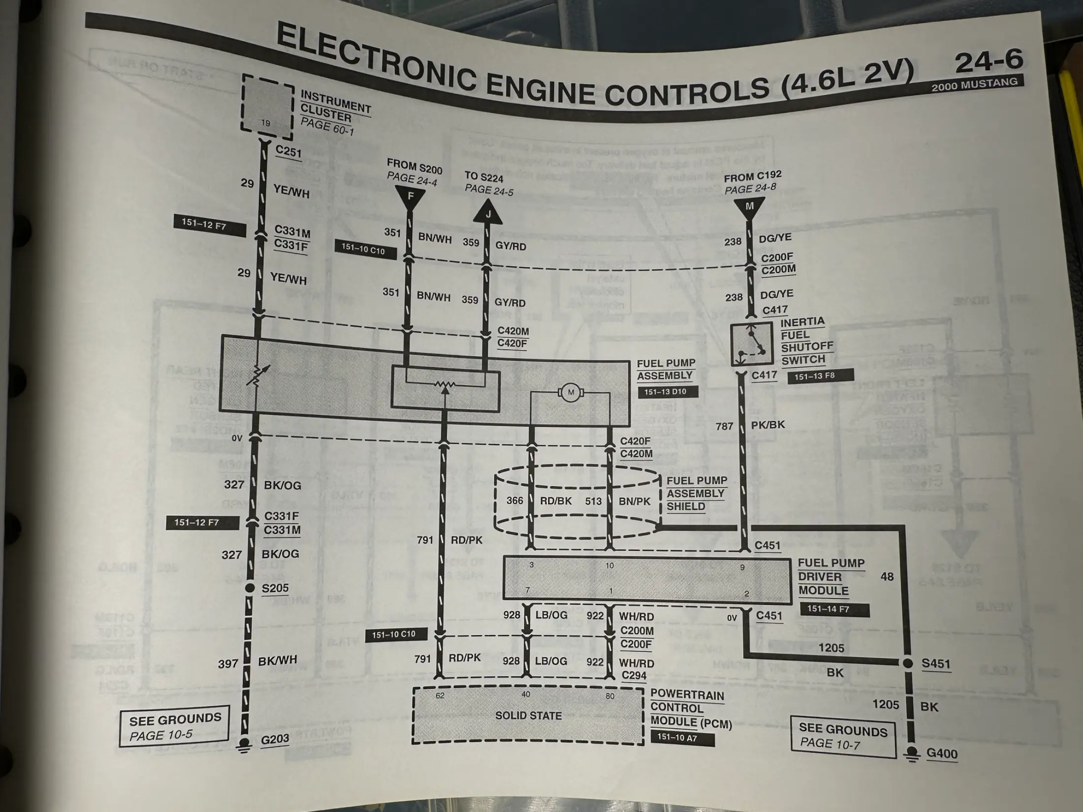

Yes, thank you for responding. The fuse is fine. I looked for the relay but my Chilton's doesn't talk about it other than showing it in the wiring diagram for the whole electrical system. YouTube says it is in the same box as the fuse but in my car, it is not. There are 5 relays in my fuse box (under the hood adjacent to the battery), none of them are the fuel pump relay, according to the owners manual that came with the car.
Would you know where it is In my car, 01 GT? I saw something about a relay behind the glove box, but I didn't think it was my model car.

Seriously? Why would they put in there, in a hidden box, sealed with rivets, then soldered to circuit board??? Great!!!!
