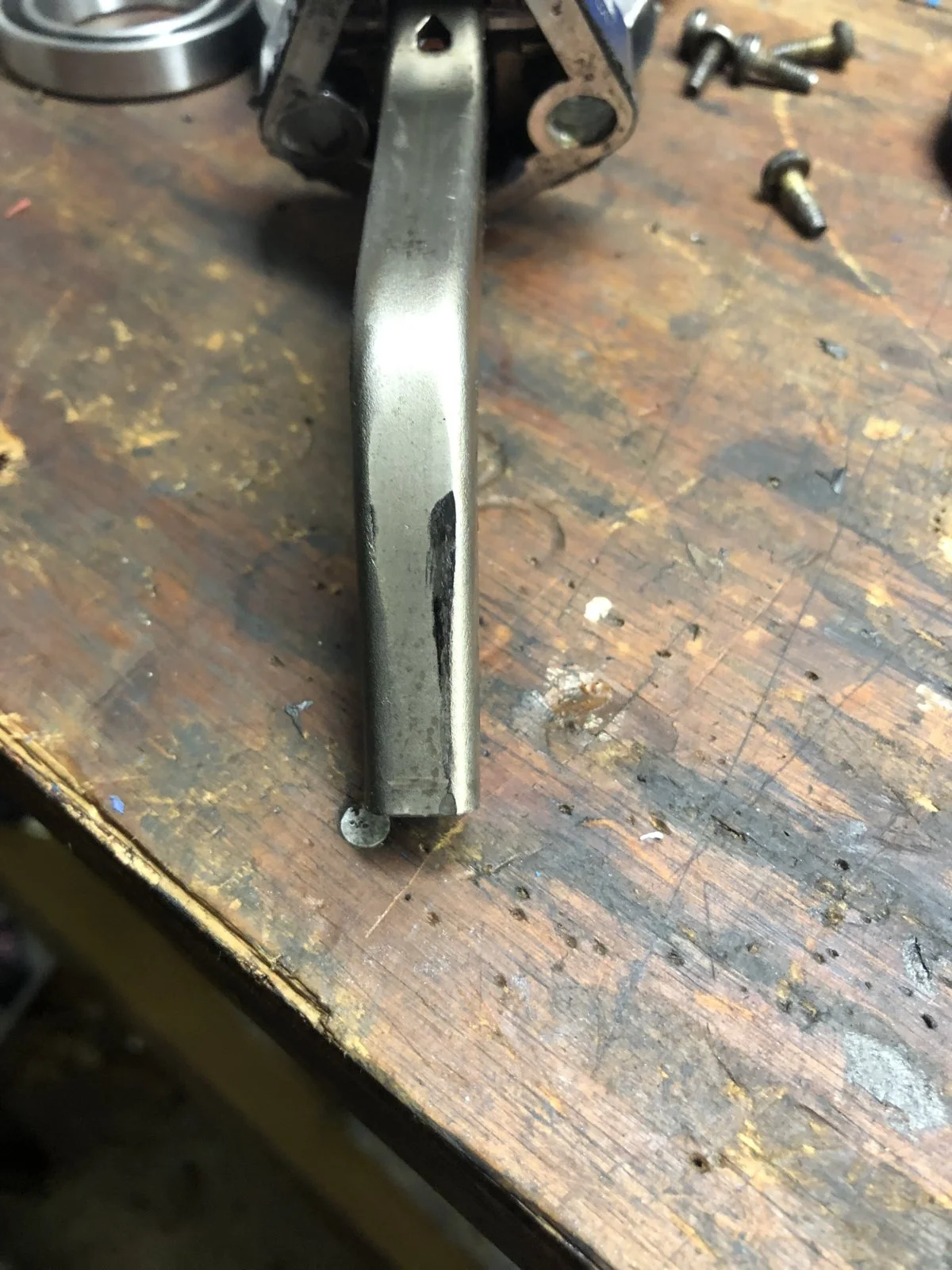

I had a Edelbrock 110 gph mechanical fuel in for about 3 years, no more than 30,000 miles. It died yesterday in a parking lot. I haven't opened it up to diagnose yet, I just replaced it with a cheap Autozone one temporarily. But I want to see what recommendations are out there, I might go with Holley or another Edelbrock or something else. Any help is appreciated.
67 289, Edelbrock Performer intake, Holley 570 Avenger, mild cam, headers, TCI C4, 9 inch rear 3.50, Pertronix Flame Thrower Dist.

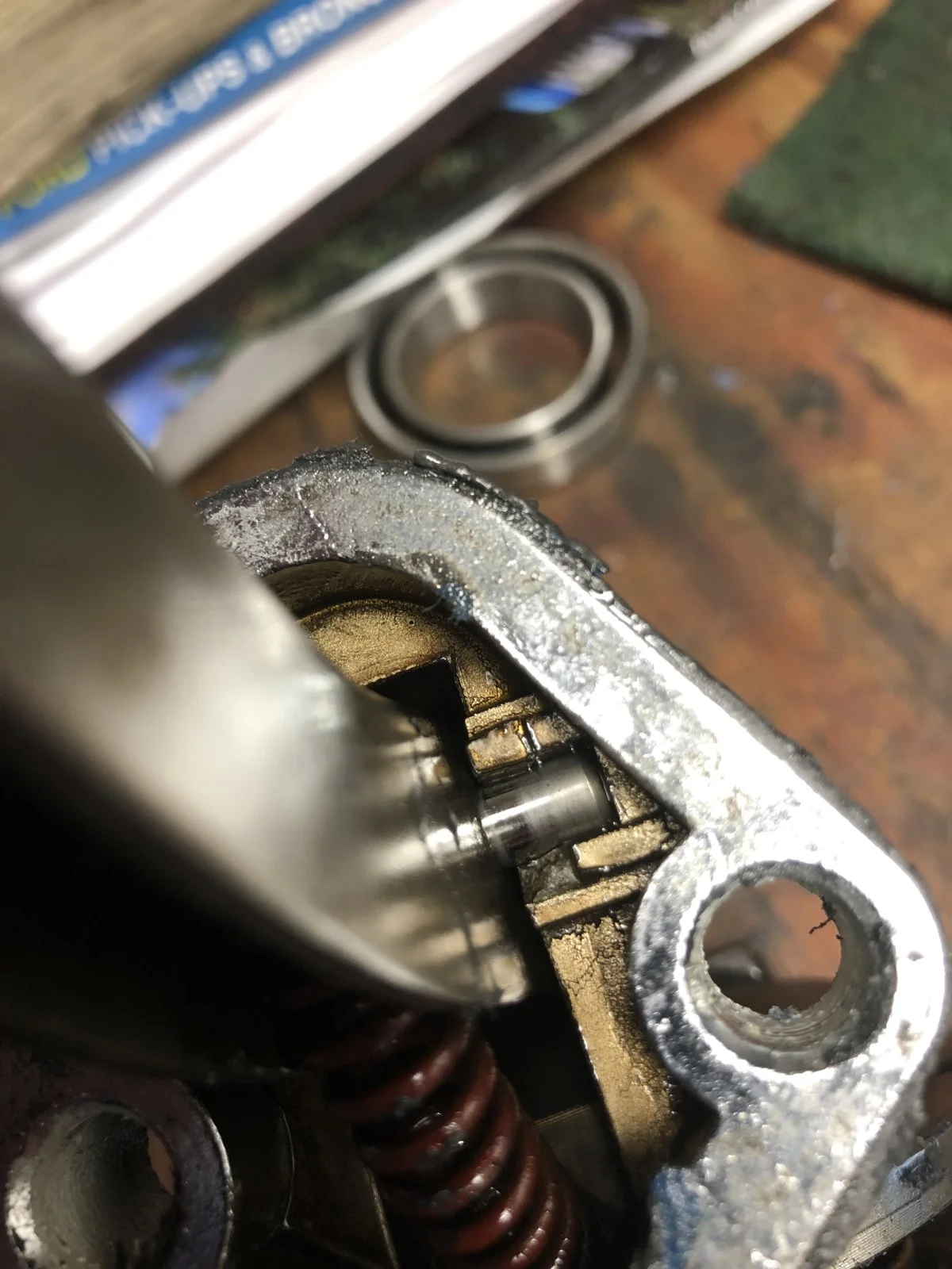

So I opened it up to find out the issue and apparently the swedge broke off part of the right side of the pin. The allowed the arm to move over and not engage the cam as you can see it rubbed on the side. Hopefully it didn't damage my eccentric cam. So maybe Edelbrock is not out of the picture.
