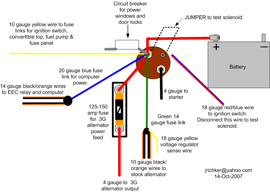

^ that's what I'd do. Don't have to take any panels off inside the car or anything. Just jump the solenoid, the small top pin to the big pin with the red wire going to it. Simple as that lol
Option 3 wild be to bridge the starter solenoid on the fender with a screwdriver. This will merely bump the starter and not prime the fuel system.
Sounds like the ticket. Good idea.
Not only does it not energize the pump, but the ignition stays dead too, correct?
How to crank engine without ignition or fuel pump being powered on.
1 picture is worth 1,000 words...
