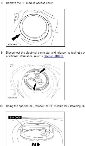

i dont see why you could not use the access holes under the rear seat, thats what they are there for.....you do need a special tool to remove the fuel pump....email me and i can send you the gas tank removal instructions that shows the special tool to remove the lock ring on the tank....
FP access
