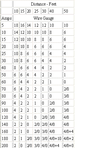

Check the fuse link....
Fuse links come with a current rating just like fuses. A clue as to what current they are designed for is to look at the size wire they protect.
Choose the fuse according to the wire size.
Wire size current table:
18 gauge wire = 5-8 amps
16 gauge wire = 10-12 amps
14 gauge wire = 15-17 amps
12 gauge wire = 20-25 amps
10 gauge wire = 30-40 amps
8 gauge wire = 50-60 amps.
Keep in mind that the wire size in the chart is for the circuit itself, not the size of the fuse link. The packages of fuse link repair material you can get at the auto parts stores also will have a current rating on them.
See http://fordfuelinjection.com/?p=7 for some excellent tips of soldering wires for best electrical performance.
