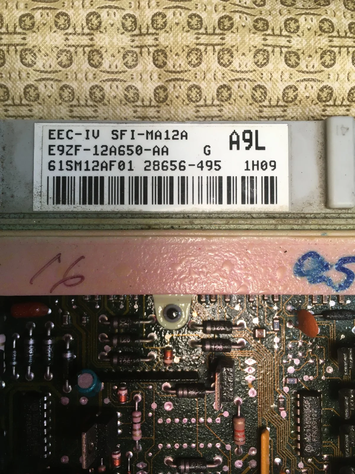

I slapped the donor ecu in and the priming event was correct. Couple of seconds run time of pump and then off. Cranked it over and it fired and ran smooth. I don’t have the SCT chip on the donor ecu yet so I only ran it for 30 seconds or so.
The capacitors in the donor ecu also show signs of slight corrosion at the connections although they haven’t failed yet. Either way I’m not gonna run the donor without replacing the caps. I’ll also replace the caps in the original. That way I’ll have a spare ecu for a quick swap if needed.

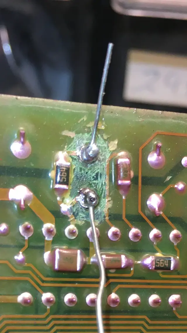

With a prayer maybe, I think I got this. One down, two to go.

well, replacing all three capacitors on that ecu did not solve the problem. The light blue/ orange wire is not grounded so thats not it either.. There must be something else wrong with this ecu. Ill use the spare ecu although those capacitors have the beginnings of leakage and corrosion so Ill replace them too. First im gonna install the spare a9l with the tuned sct chip and test drive. If all seems good Ill pull it back out and swap out the capacitors then put it back in and test again.

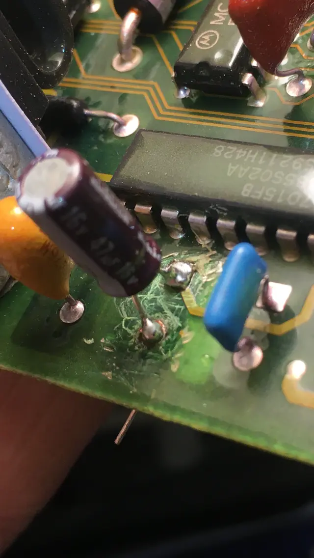

To follow up on this post I have installed a replacement ECM A9L in my 92. I inspected the capacitors that the vendor had installed and they were a different rating than stock. Stock would have two 47uf 16v and one 10uf 63v.
In past research I had seen it mentioned that you can increase the voltage of these caps but the uf ratings should stay the same. Upon receiving the replacement A9L, I opened the cover to see the work inside before installing the ECM in the car. What I discovered was that all three new caps were 47uf 35v. Since the uf rating had been raised on the one, from 10uf to 47uf, I thought maybe a mistake had been made in the refurbish process of this ECM. So, I contacted the vendor to question them. They told me the change from 10uf to 47uf on the cap in question was intentional. They said Ford had originally under rated this particular capacitor. They said that on some of the ECM's that were returned to Ford for repair, Ford itself was changing the 10uf to 47uf. They ensured me the ECM was ready to go and insisted I would be happy with its performance. It's been working good since I installed it thus far.
Anyway, I wanted to report this to see if any of you have opinions on this change of uf rating on one cap because I've seen it mentioned that the uf rating should not be changed. Again, I was clear in my questioning to the vendor and they insisted what was done is an improvement. There was a thread at Corral where a poster mentioned he had found all three caps in his ECM to be of the 47uf rating too.
