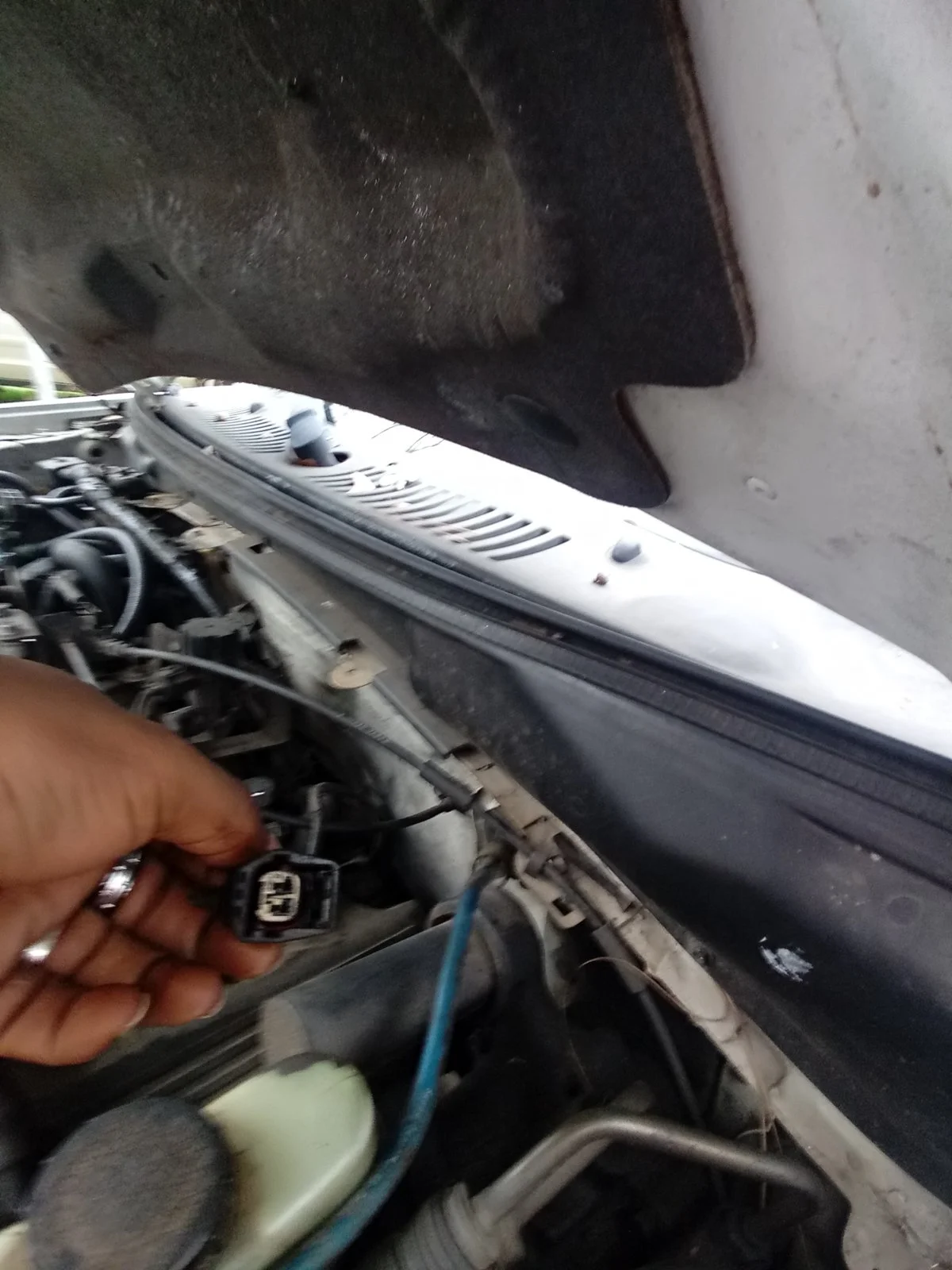

Naw i found a wire that loose coming from behind the motor...its brown and red and needs to be plugged up somewhere but dnt knw where

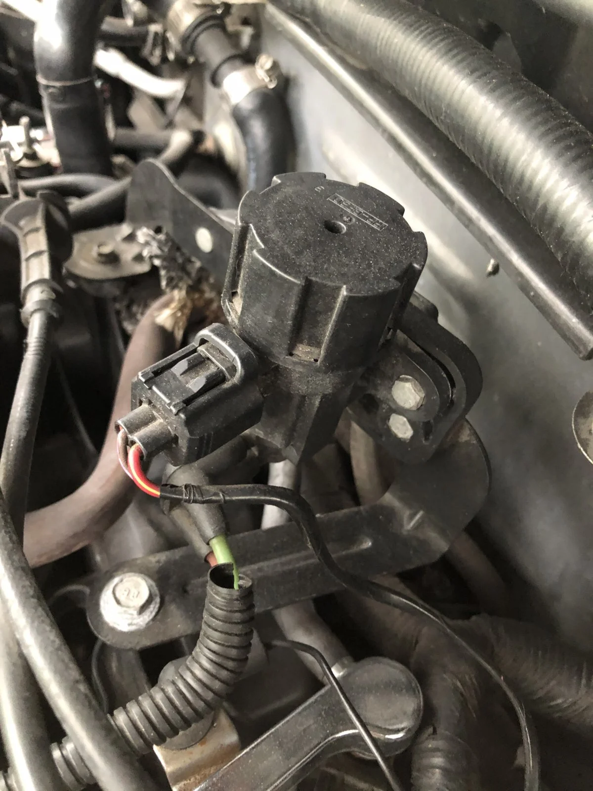

I just looked at my 2001 GT and the only wires that look close to that in that area plug in as seen in the picture. You might check the fuel pump fuse also. If fuse is good depress the schrader valve on the front of the right side fuel rail and see if you have fuel pressure.
