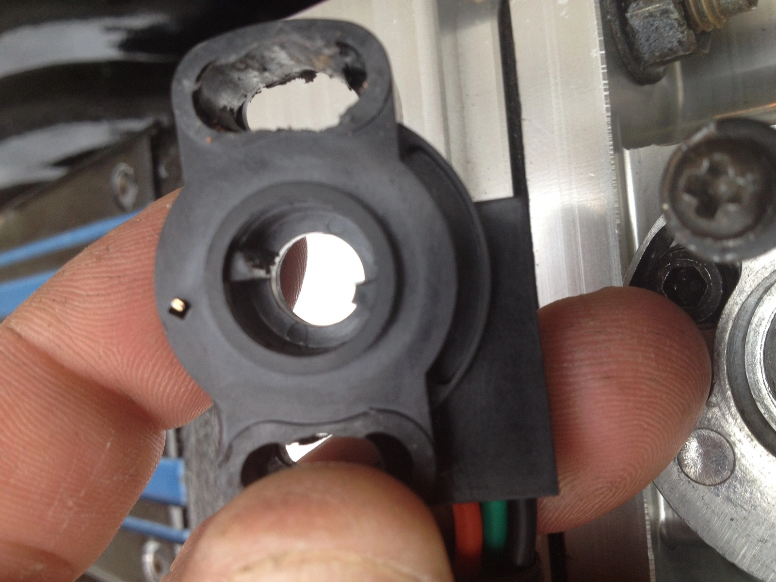

Wtf did you do to that thing? Buy a replacement. Do not cut it, do not try abd adjust it. Ford tos is NON adjustable.

had to elongate the holes to adjust voltage. When putiing on TPS voltage is .288 wont turn on pump. the center is what concerns me. why would it eat off a flat? the butterfly tension is not that great.

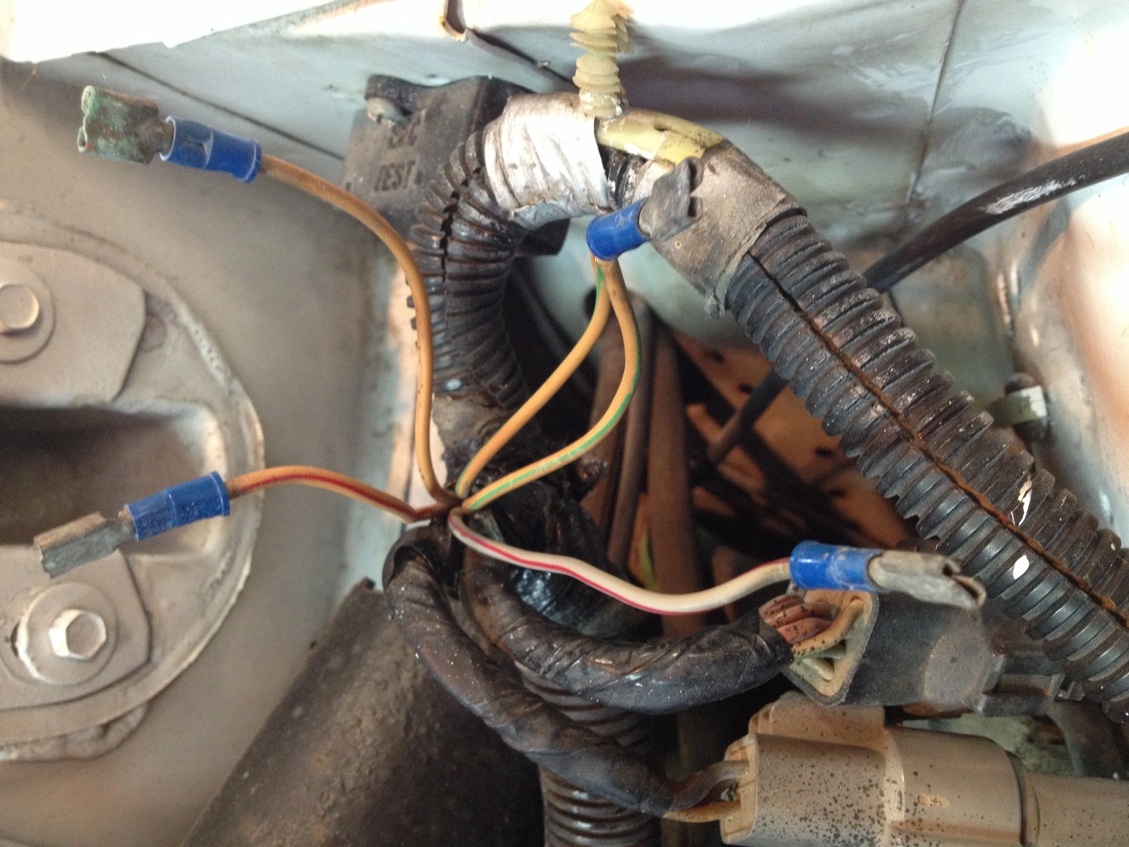

I cleaned them and would still call it gray/red. So would wife. Here is a pic with wires out of connector.

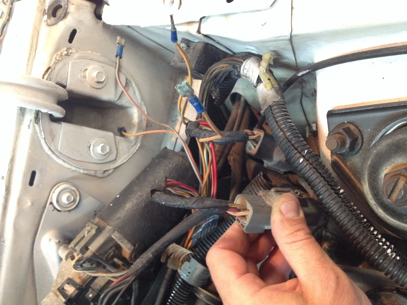

These 2 connectors running off main loom have a white/red unbroken wire but no other white/red or black/red nearby? LOL

Found the STI connector gray plug under the booster but still no white/red wire.
The gray connector shown in the other picture isn't for the computer test point.
Peel the covering off the harness a little bit and I bet you'll find the gray/red wire is a white/red wire. If so, then ground it to a black/white wire or to the battery negative post.

I wish it was but it was not. i peeled back the harnesses to center of the firewall and it was clean and gray/red also peeled covering back to the coil and to the firewall. no white/red wire to be found......
