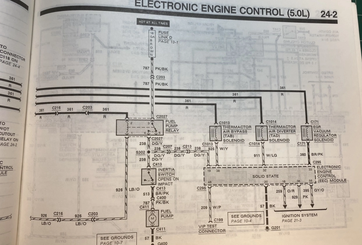

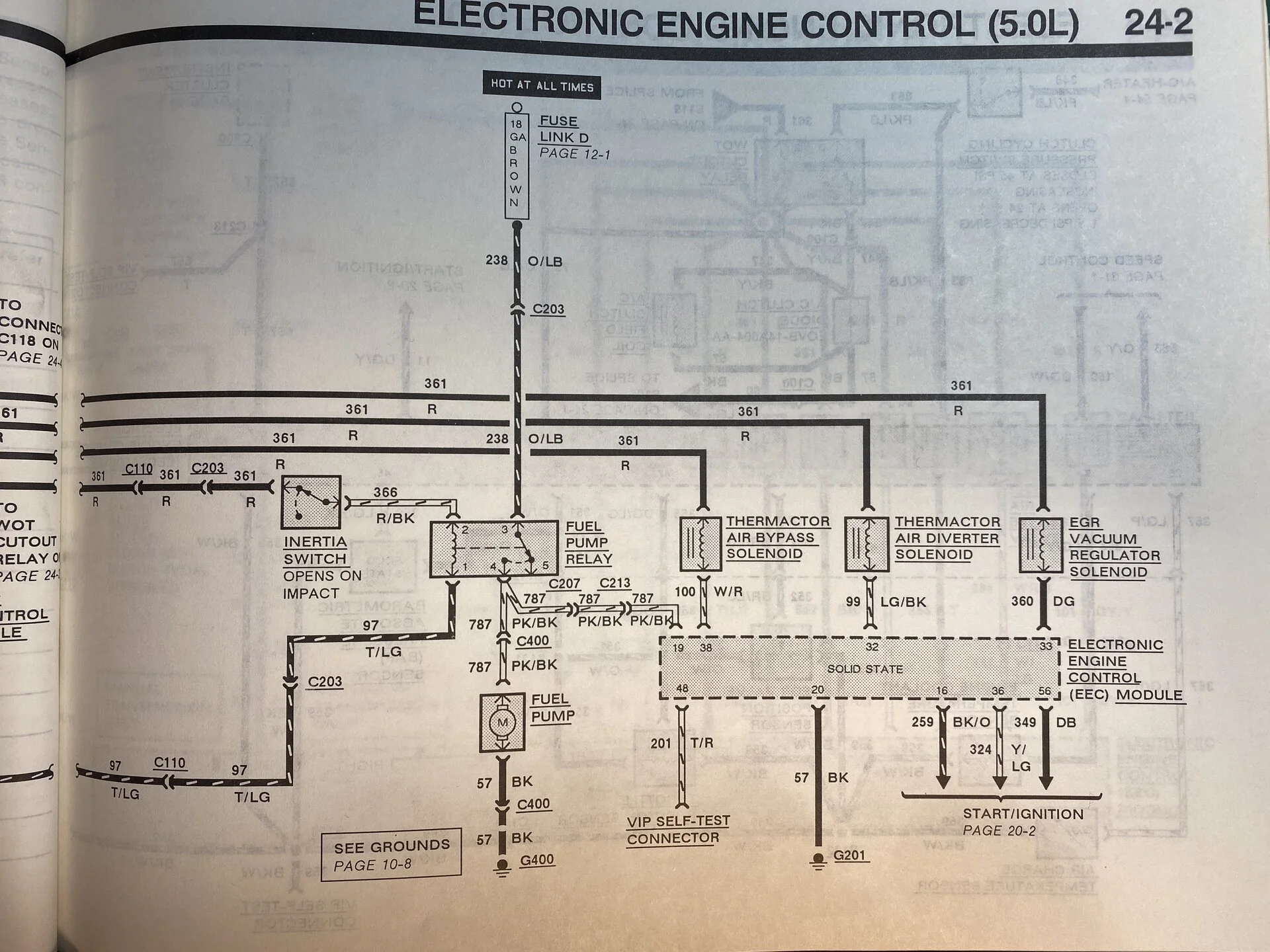

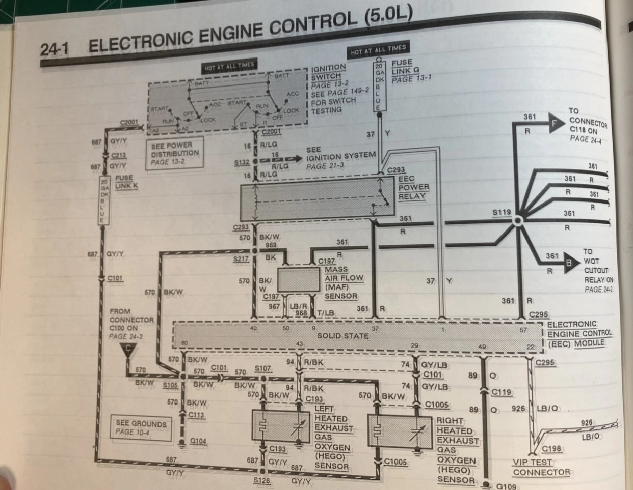

Hey man just wondering if you could send a full picture of the wiring diagram for a 1991 gT fuel pump relay. I know you posted part of it in another form just couldn’t read all of it. Thanks in advance!
Do you mean the other page? I can get that for you.
Wire 361 connects to the EEC relay, and wire 97 connects to a pin on the ECU. I'll grab the other page later

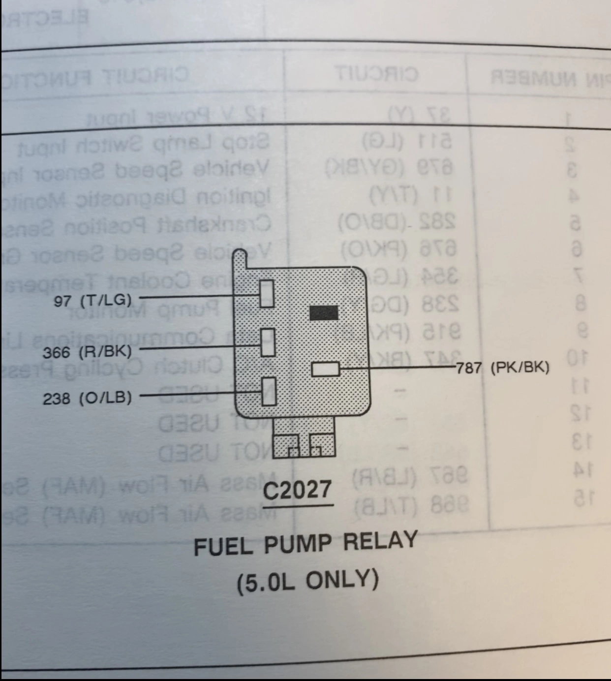

Actually I need a layout for the connectors for a 1990 car. Sorry about that. Specifically C110, C203, C213, and C207. I’m installing a classic FAST Ecu into the car and I’m trying to tap into the negative side of the relay. Thanks for the help!
The EVTM doesn't have every single connector pinout. It will probably have C207. I'll see what i can dig up later this evening.
