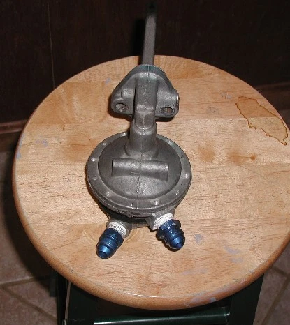

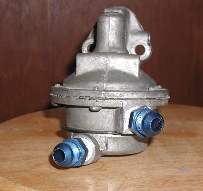

Problem solved
Didn't get much sleep last night, but I decided how to proceed. This morning I disassembled the fuel pump and drilled and tapped the outlet for 3/8 NPT. Next I enlarged the hole at the back to the same size as the i.d. of a -8AN fitting. Then I installed a 3/8NPT to -8AN fitting in the outlet with teflon sealant. This seemed to be the obvious solution, allowing me to use all the existing fuel lines. After I get everything dialed in I may redesign the supply line to mimic the Boss 302/428 CJ layout by swapping front carb bowls. Anyway, I reinstalled the pump on the engine and re-connected the fuel lines. This will work for now. Still not sure how to adjust the regulator , but hopefully with the stock fuel pump it really isn't needed anyway. With the -8AN inlet and outlet I should have an HVLP fuel system.
