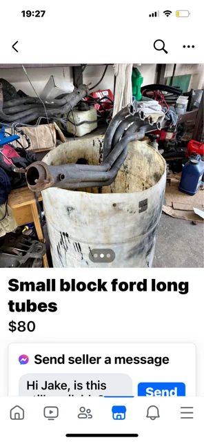

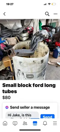

I ran across some full length headers however I have no clue if they are Foxbody type. Owner states they came with a 84 Foxbody. It would be a long drive to purchase them. Opinions?
They look like the old MAC headers due to the individual primaries i.e. there is not a once piece flange to bolt the header up to the head. I had a set of MAC's and could not get rid of them fast enough due to getting the primaries bolted up to the head after they had heat cycled was damn near impossible. Price is nice but for me they are where they should be which is minimal effort from being in that trash can.
I guess it would depend on how badly you want them given what @AeroCoupe says - you can buy a new one piece flange and rework them. Question is are you able or do you want to? You could have a set of long tubes for 80's or 90's prices if you went that route.... :shrug:
Mac 1 5/8" 5spd headers. I'd grab them, A kiddie pool, A gallon on Transchem muriatic acid, some baking soda to rinse them off and neutralize it, then some silver rustolem bbq paint look good as new. Buy some header or 3/8-16 studs, cometic MLS or copper header gaskets and rtv will help with lining and sealing them up if any warpage. Bbk mid pipes don't fit mac though so have to make your own or mod one.
