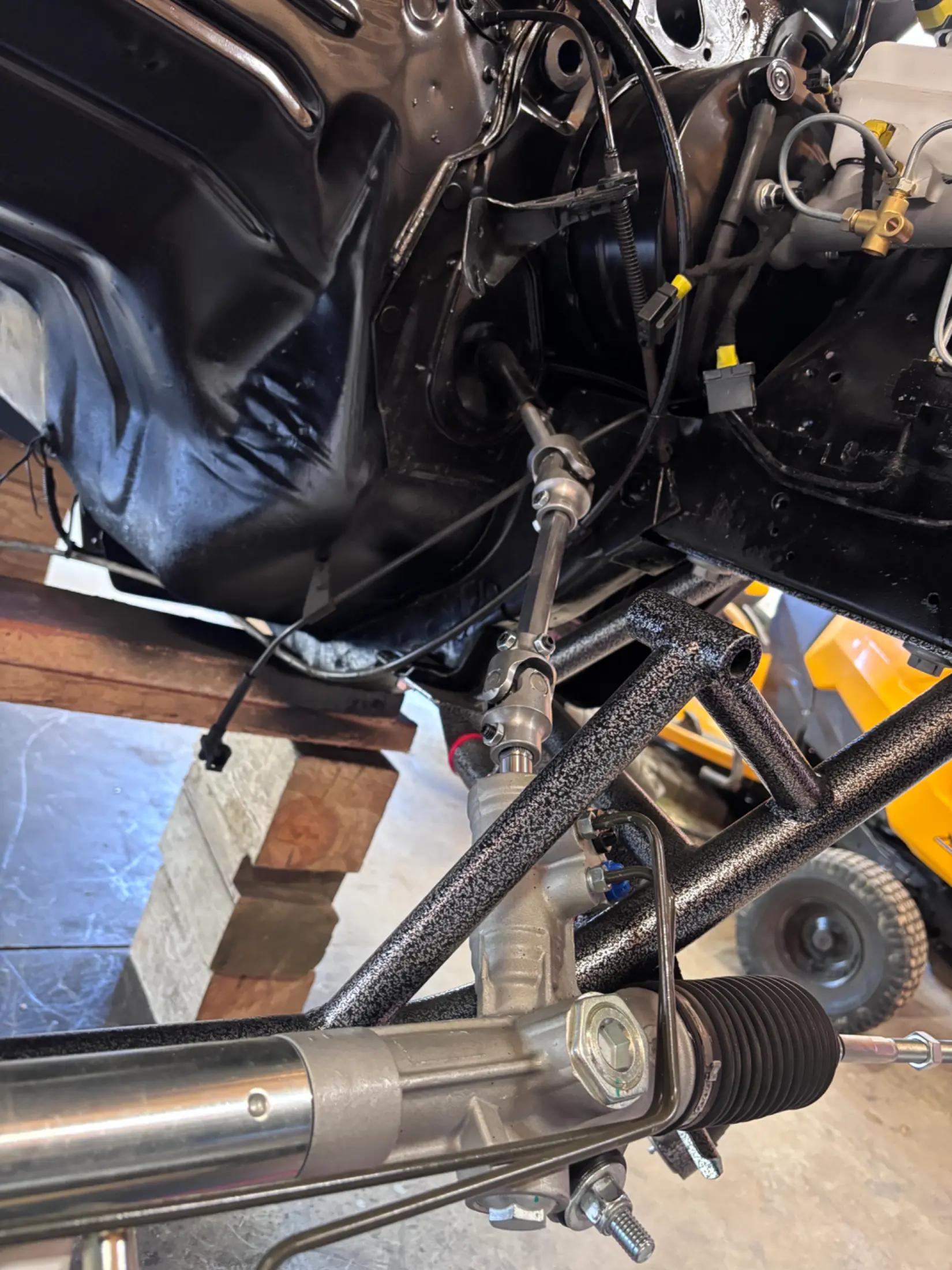

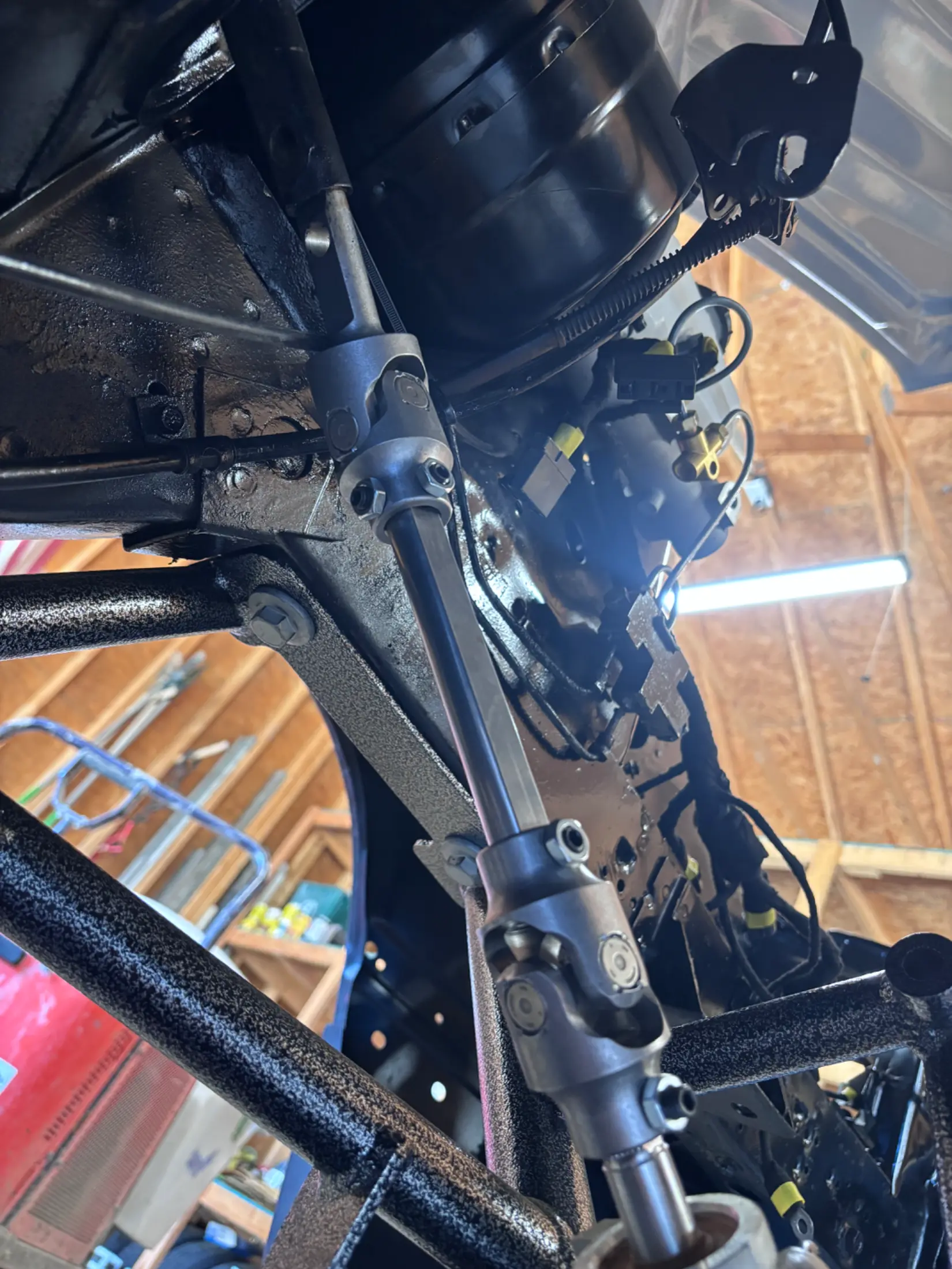

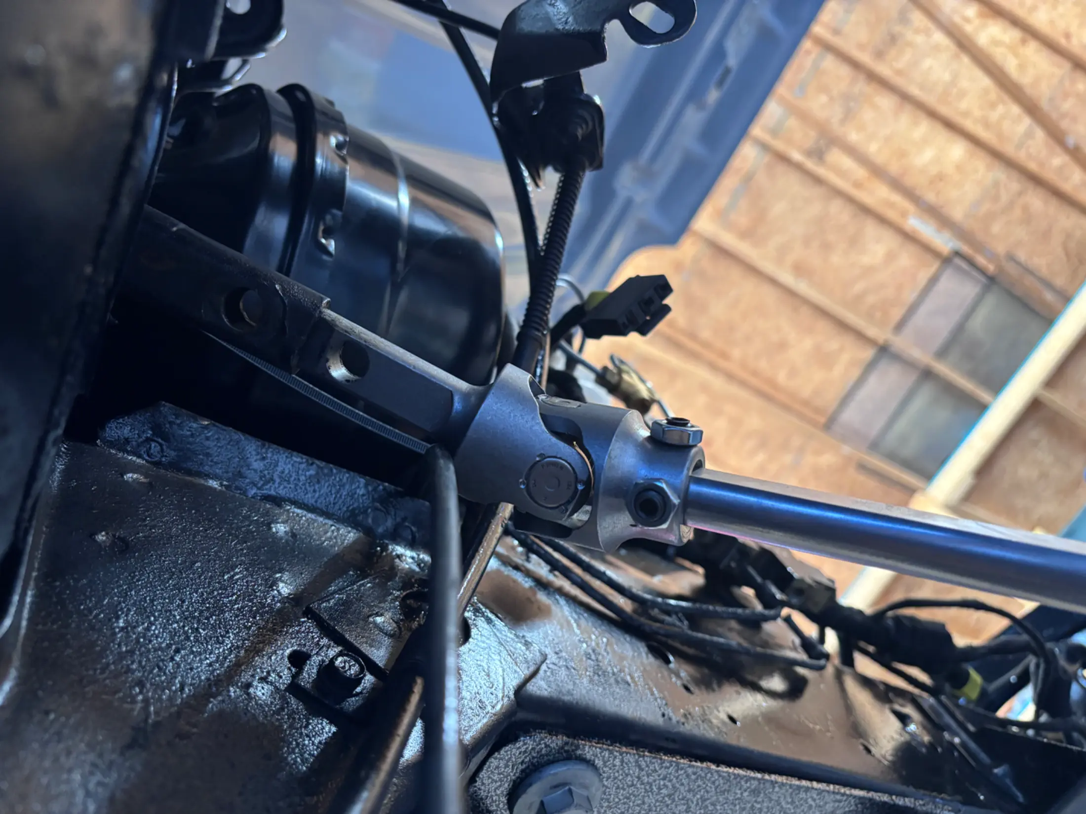

I have a complete rebuild foxbody 1987 and I bought the k member support from team z for a ls swap and a new steering rack also. I purchased the borgeson steering shaft and it’s about one inch short. Any help here? Second steering shaft as I thought the first one was a mistake. Thanks in advance

You need to pull the steering column shaft out of the steering column.
