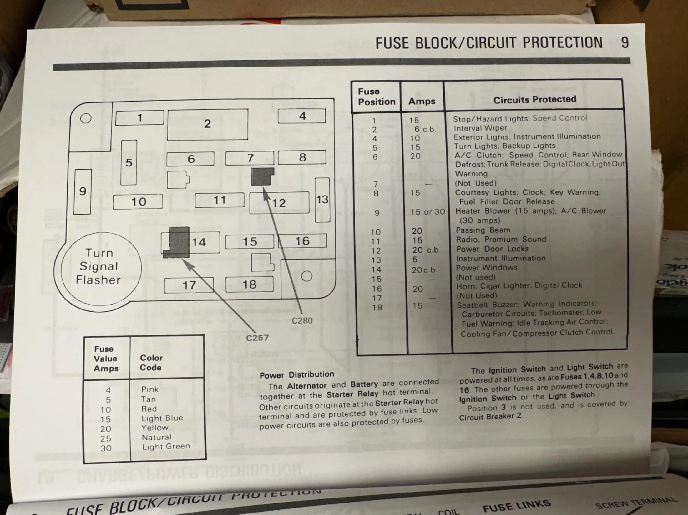

Got in there today and see I have no power to the fuse itself (#9) so I started looking for a fuse panel wiring diagram but for whatever reason I can't find anything.
Can someone direct me to a wiring diagram page or archive please? (Yes, I've been searching for 45 minutes and am not getting anywhere, lol)
