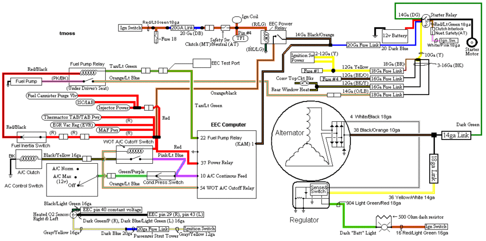

See the following website for some help from Tmoss (diagram designer) & Stang&2Birds (website host) for help on 88-95 wiring http://www.veryuseful.com/mustang/tech/engine/
ttp://www.veryuseful.com/mustang/tech/engine/images/IgnitionSwitchWiring.gif
