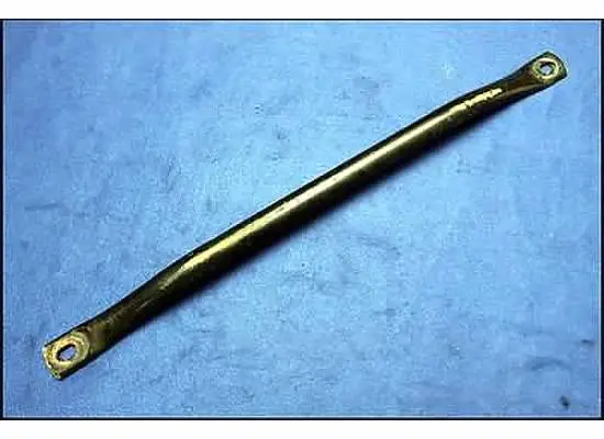

Where does the G Load brace mount on the rear ? Anyone added one to a 2.3 and if so how did it compare to w/o it ? Description says
OEM 96 97 98 cobra g load brace
. I'll be picking a front Eibach sway bar , GT rear bar and a set of KYB shocks but I'll be at the U pull before picking them up . There should be 2 or 3 SN95's in the yard . Pulling two bolts is easy enough if it's an upgrade . My rear shocks are shot . Well soft anyway . Way too soft for me . Looking for a strut tower brace and sub frame connectors the next time I get a chance to get out . Need to get the lower mounts as well since the shocks are off a GT and with 1500 miles on them .
How much of a difference between 2 point and 4 point .
I was wondering what are quad shocks . Saw a diagram and they look like they take the place of the rear upper control arms . I would think these are not a must have for a sock 2.3 . They look like they would control wheel hop if I'm reading the pic properly . If anyone has a G Load brace and a pic or can elaborate , please do .

I'm coming from V8 country, so I hope you go easy on me. The G Load braces I've used bolt in the front suspension, to the bottom of the K member, 4 point mounting preferred, and they make a noticeable difference all by themselves. I've removed the quad shocks on all four Fox Mustangs I've owned (after installing aftermarket rear lower control arms, which also largely eliminate wheel hop). On the strut tower brace, I had a 4 point installed, and had to convert it to a 2 point (to clear a larger intake), and really didn't notice the difference. If I could, I'd still go with the 4 point. The biggest handling differences I've seen come from: 1) tires, 2) subframe systems (look up Stifflers FIT or Kenny Brown Extreme Matrix, and 3) poly or other harder material bushings everywhere, preferably with new control arms at the same time. Springs will also make a big difference, but I'd do these three things first.

I had strut tower brace, 4-point g-load brace (both maximum motorsport) and subframe connectors on both my old '90 and my old Turbo Coupe. The stiffness and handling improvement is pretty big! I personally didn't think a 2-point g-load brace really did a lot.
Red LX did you install the g load brace separately or all at the same time ? If all were done at different times which one made the most improvement .
Wait, scratch that...I never put the 4-point K-member brace on my Thunderbird, it wouldn't fit due to the K-member being slightly different. I did have both on my '90.
I personally noticed much more of an improvement from the strut tower brace than the K-member brace. Noticed an improvement from the subframe connectors too. I think the STB and subframe connectors should be two of the first chassis upgrades for a Fox chassis car.
I put a 2-point brace on my LX at one point. Removed it a few times, and then reinstalled. Never felt a difference at all.
Currently off the car, but i'll toss it back on at some point just because it's not worth selling
