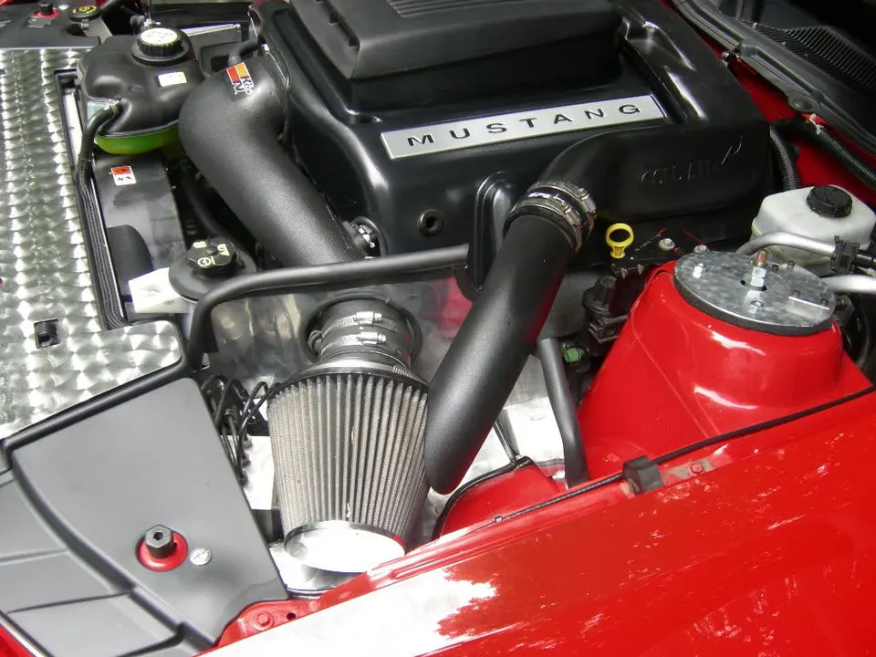

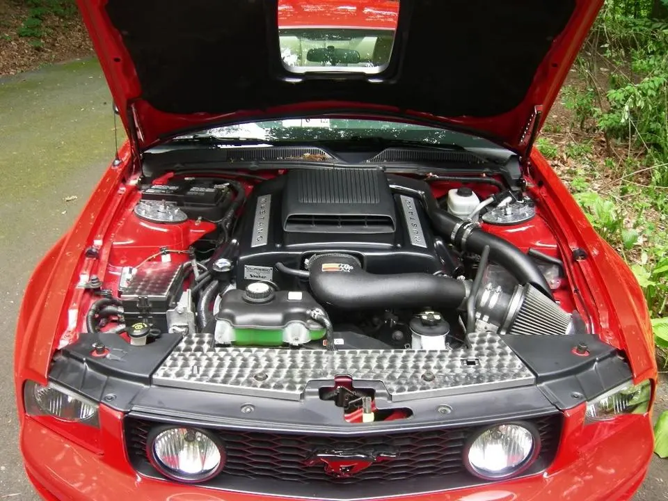

I would think the Shaker would only be functional if the intake were plumbed directly to a nicely sealed airbox. You definitely don't have that because you're running a JLT intake which is exposed. You probably will not see much gain from it other then possibly a cooler (and at times wetter) engine bay.
If you go with the stock air box the Shaker dumps directly into the closed air system. I had to make a few adjustments to mine to dump the Shaker Cold Air directly into the aftermarket CAI. But it works beautifully and you can see on the filter where the air has been flowing.
