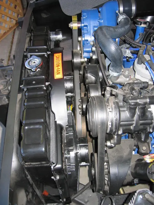

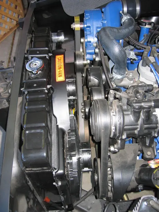

Here is a shot of the shroud I built for the '66. there is foam against the radiator and the shroud, to get a good compression fit. Once it is dialed in, the foam will come off, and the gaps will be filled with an epoxy/glass/micro-balloon mix, for a clean finished look.
