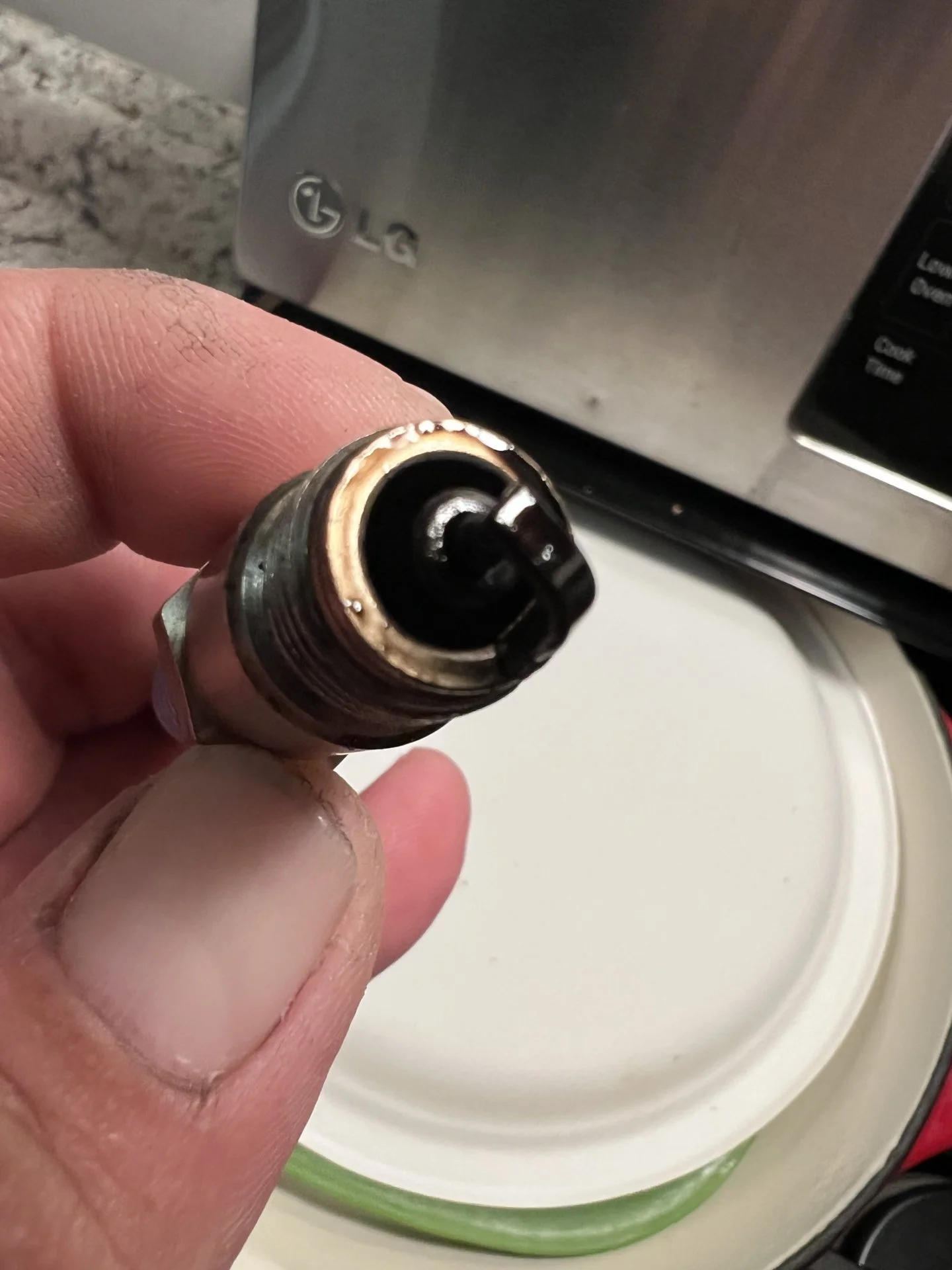

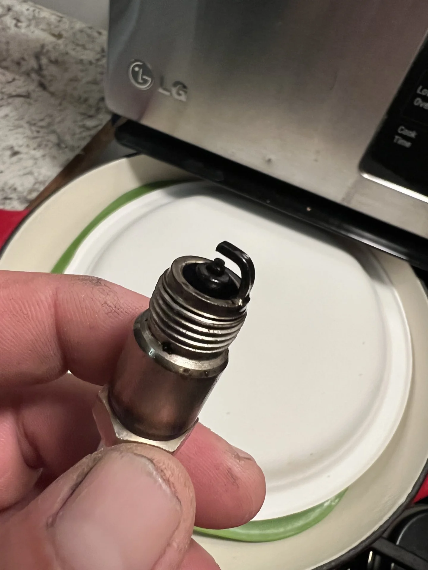

I took pics of the plugs seems to be oil because I left out overnight and I don’t think they dried unless it’s black from running rich
