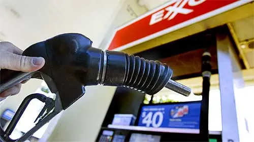

The difference is in the wimpy little unleaded gas nozzles in use today. These cars were built for the big manly leaded gas nozzles, now almost extinct.
We have these large boot type which require you to put pressure on 'em against the filler neck and hold it tight to get the vapor recovery to operate. If you loose the seal, it kicks off. A real PITA.

I have the same trouble with my 67 coupe. What I've found is that if the boot is in good shape, I usually don't have a problem but if I see that the boot doesn't sit square against the gas filler hole due to being old, it will usually spill gas from the start. I just have to leave and look for another station.
Unlike modern cars, we have to pump gas. I find I have minimal problems if I hold the nozzle at a 90 to the bumper (as opposed to down). New cars have the filler angled almost straight up and work unattended.
Like I said, it's the government's fault. When they mandated unleaded gas, the required unleaded cars to have restrictions in the filler neck for new, tiny nozzles, so people wouldn't be able to put the cheaper leaded gas in their unleaded-only cars- The "normal" nozzles were way too big. The big nozzles worked just fine in Mustangs, they were about twice the size of the ones we have to use now.
Bet you just thought this was crummy design on Ford's part? Nope- Just another example of government regulation screwing up your life.

It doesn't have to seal on the smog versions, as much as you need to make it think it has. I always grabbed it and pulled it back, and barely stuck in the nozzle. Then shot it up against the roof of the fill neck
