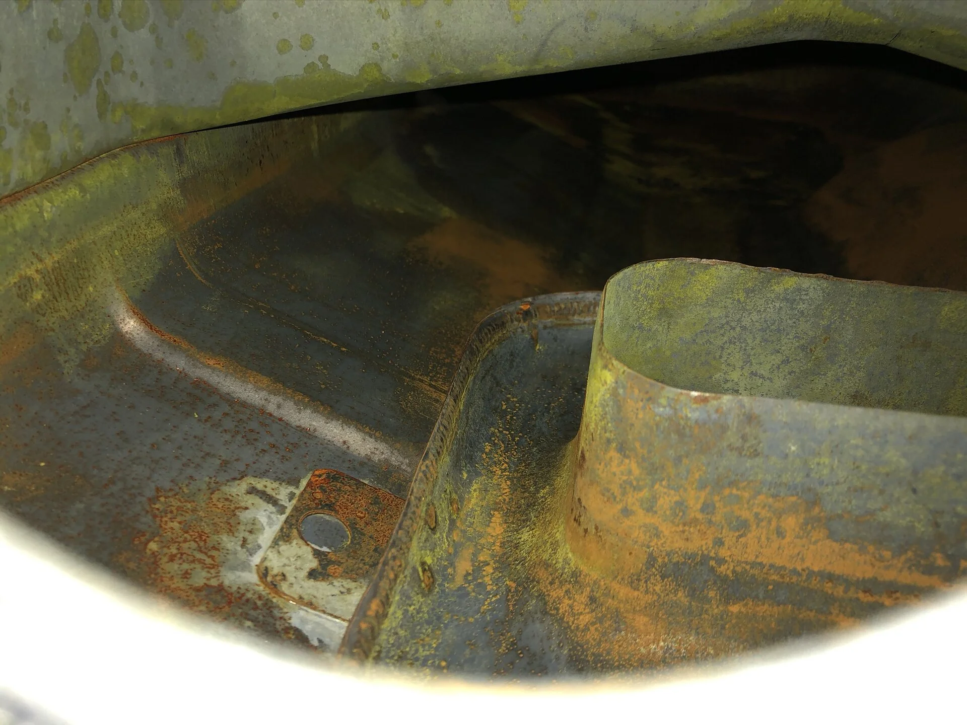

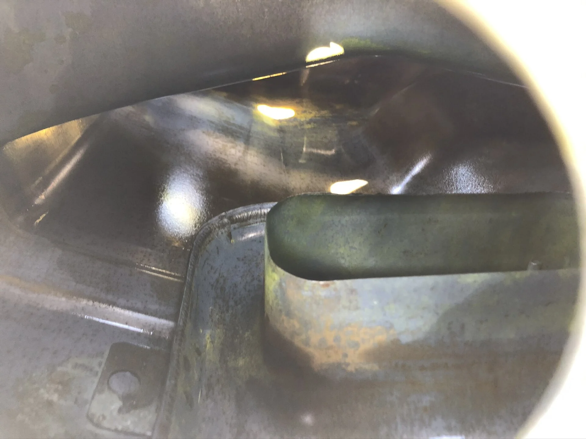

It appears I’ve created more work for myself.
Top picture is after 24 hours of Evaporust and rinsing. The bottom picture is this morning, after drying for over 12 hours. Where did I go wrong? Is the green stuff some sort of coating ( such as zinc chromate) that rinsed away with the rust? Was using a power washer inside a bad idea? Either way, it looks like I’m starting over.
I’m considering using Red Kote once I sort this out. Thoughts?
you would have had to put a protective oil coating or something after rinsing.... it flash rusted... I bought some 94-95 fuel rails to use on mine... had some surface rust inside them... I soaked them for weeks in that evap-o-rust... worked great... I rinsed them with hot water in the sink.. then I blew dry with air, then I spray brake cleaner in them.. and blew dry again... then I sprayed engine fogger in them (what I had for my motor)... which got them nice and oily, then I wrapped them up and put on shelf for when I get ready to install them... they come out damn good...
I would just buy a new tank, think there like 100-125 $.

Is it humid outside?
I agree. Flash rust. You'll have ti try it again and then lightly coat it with something.

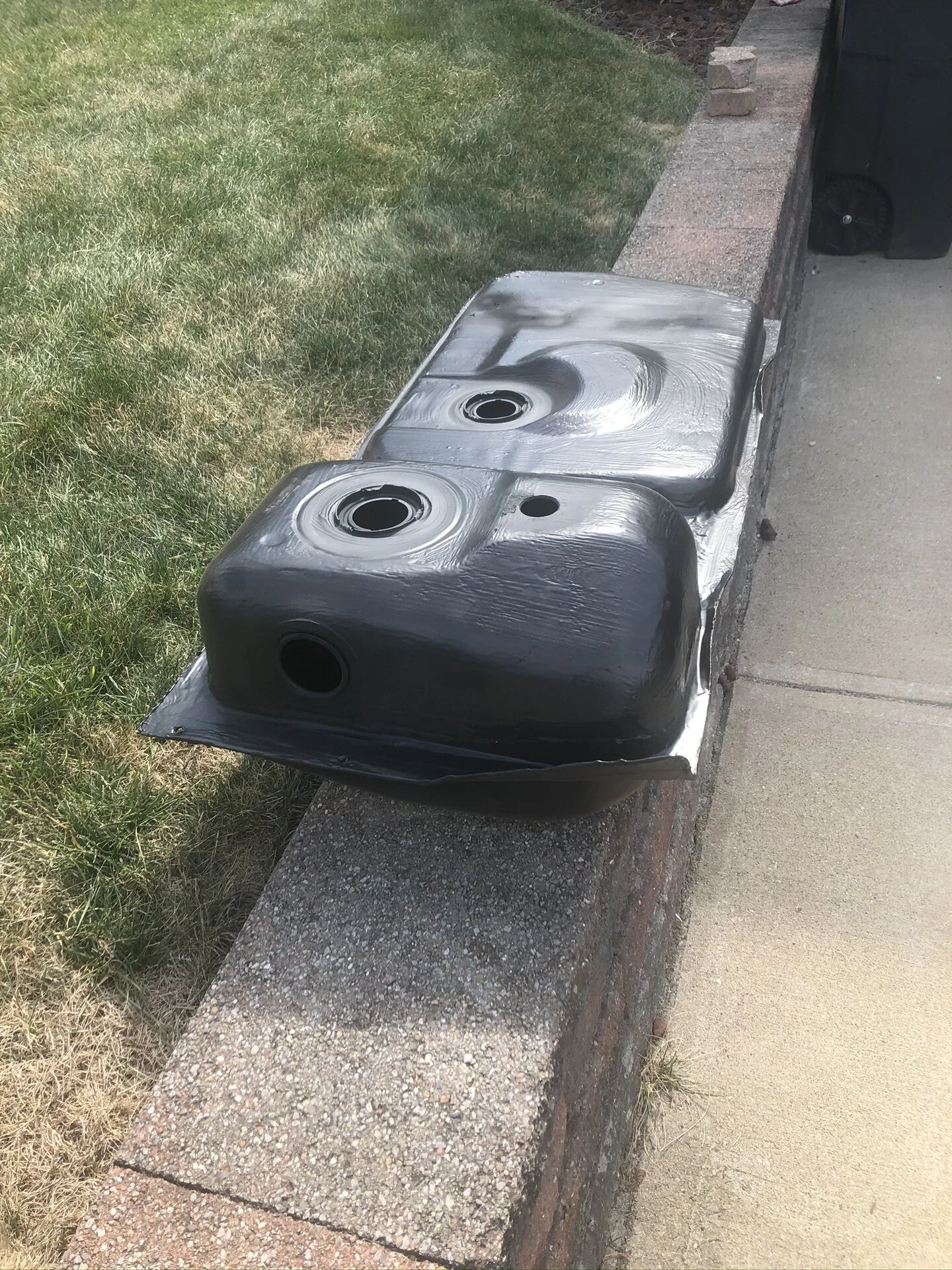

So, after much internal debate, I decided to have the old tank refurbished by the place I mentioned in the OP. I would much rather have piece of mind ( and a lifetime warranty) of a pro shop doing the work than myself mucking about with POR or Red Kote it and still not getting it right. I know a new tank is much, much cheaper, but there’s no way it’s the same quality as the OE one. I’ve saved a great deal doing much of this car myself so far, but I know my limits and level of patience.
That this place is within an easy drive rather than shipping made it a bit easier of a decision. Plus, supporting small business, not buying a gas tank made overseas, etc, etc. I opened the hatch to my minivan at the shop and the guy knew it was a Fox body Mustang tank before I told him. “We’ve done a few of these”. Well, here’s to one more and hoping I never have to drop the tank again.

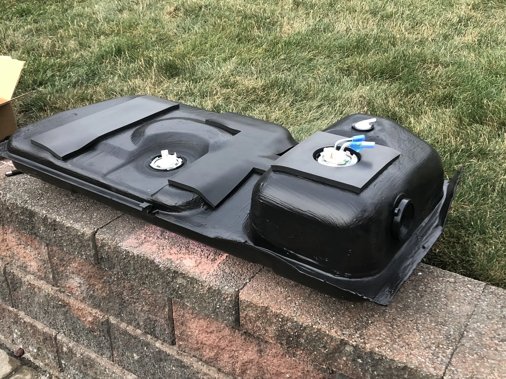

Picked up my tank from the refurbishment shop today. It is coated inside and out in a super thick coating that was baked on. It’s not the prettiest thing, but since it lives under the car in its cover, I don’t really care, just throwing it out there for those who find this thread. If I was building a show car, I’d care. But if this is the last time I have to see it in the cars life, that’s fine by me.

Nice!! All you see is the plastic cover and the straps anyway!

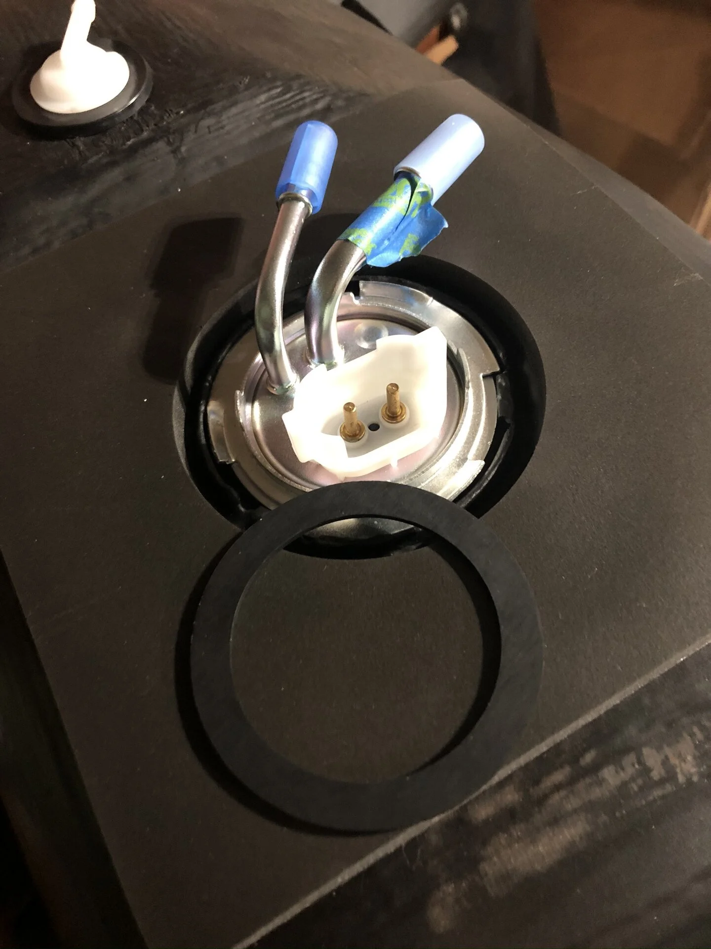

Refurbed tank already to go back in with new pump, sending unit, filler gasket and pads.
One question:.The new fuel pump came with the lock ring gasket and another gasket, but I don’t know where it goes, if it goes anywhere. Between pump hanger and tank? It won’t fit between the lock ring and pump.
I only remember taking the lock ring gasket out. Is it for a different application and just in the box?
Edit: Checking the service manual, it only shows the lock ring gasket, but any additional input before I lock it all down and cram it back in the car is helpful.

I just replaced my fuel pump (Walbro 155) and it only came with the one gasket for under the lock ring.

I put one gasket under the lock ring
