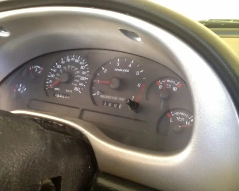

What you can do instead is take off the needles and paint them red like I did. But the PITA part is to calibrate them, its actually very simple just make note of where the needles are before you take off the needles. To change the color to red you need to sand off the yellow on the bottom of the needle and paint it red or whatever. you also need to break the bottom of the black part so you can expose the whole needle. It will still work without the bottom black part. You will understand what I'm saying if you decide to do it this way.
this is a 95 mustang cluster with the needles painted laser red. Its my car.
looks like you didn't calibrate the oil pressure needle correctly, unless it always runs that high :lol:

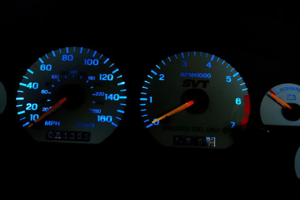

I was thinking about getting the SMD ones that covers 360*. So i don't get no dark spots on the cluster, Which one do i need?
Just as i said last time i did the LED thing on the cluster, i ended up with buch of dark spots, i wasn't too happy with results...
