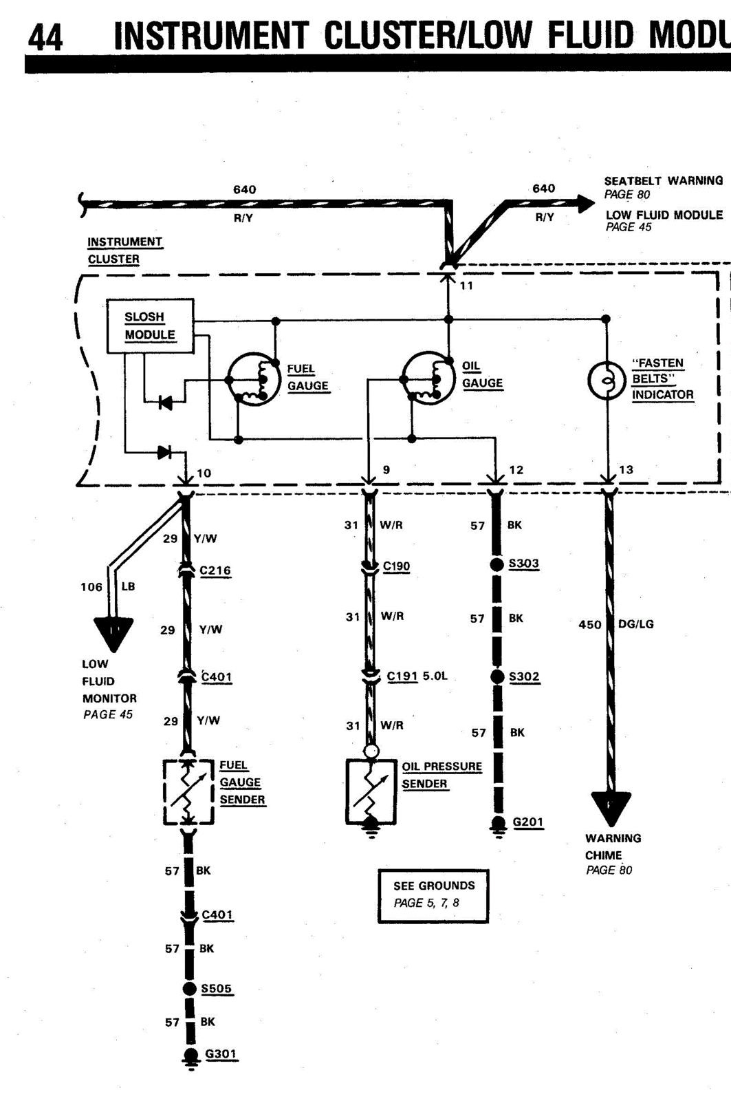

Isn't there a voltage regulator module on the back of the IP?
It is actually an anti-slosh module for the fuel gauge. Notice on the diagram that the voltage source and grounds have a common source. The voltage inputs are all tied together and the grounds are all tied together
