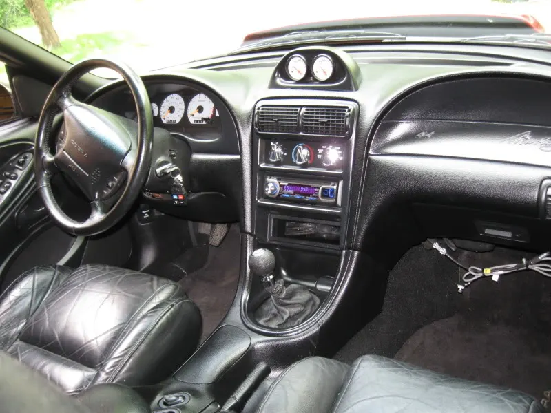

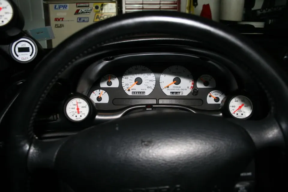

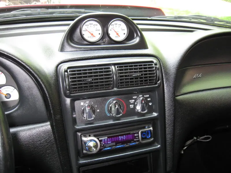

I like those steering column gauge pods - think they look sharp, but I personally run oil press and water temp in an A-pillar gauge setup (Autometer).
As far which types of engine monitoring gauges you would want, a lot of that is simply personal preference - I went with the two choices above because I felt that those were the most crucial for my situation (NA engine, no power adder - otherwise I'd look into adding a boost gauge, wide band O2, etc). You can add pretty much whatever you want - oil temp, volts, and so on...
I don't personally care too much for the clock pod mounting area, but many others like it. You can also do a custom job and install them where your HVAC control panel is - seen that on a few other cars.
Go with whatever mounting location you like best; A-pillar, steering column, clock pod, HVAC panel, etc.
BTW - As you may or may not know, the factory oil pressure gauges in our cars are nothing more than a "dummy" gauge because they are set to point almost directly in the "middle" of the "low" and "high" mark on the dash.
IIRC, the factory oil pressure switch/sending unit simply reads a signal and if it sees more than something like 6psi of oil pressure, the needle of the factory oil pressure gauge will point to the "middle" and lead one to believe everything is just fine. Of course, once you fall below 5 psi, your engine is probably toast so it's a little more comforting to run a "real" oil pressure gauge so the driver knows how their engine is actually running, etc.
Many people weren't happy with the factory "open/close" oil pressure switch that Ford used in these cars but I think it was done to prevent people from complaining about their oil pressure needle moving around eratically. Those people may have been mistaken and thought something was wrong with their car when the needle "moves around," as silly as that sounds... :shrug:
