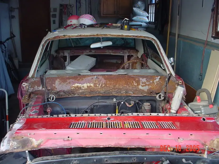

Just to give you an idea:

Geo, yours looks like mine before I fixed it...
Pazur, unless you need to repair the cowl underneth, not worth the trouble. But if you do need to repair it, this is the way. I had to find another cover as mine was so far gone it would have taken a ton of time to repair and probably looked like crap.
