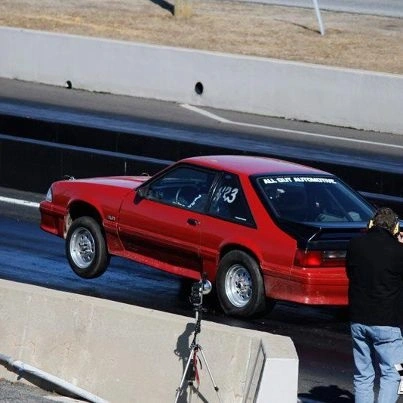

Here is that particular car from 2 weeks ago testing. He drives this car over 45 mins to get to the track, usually rips off 3 or 4 passes and drives home.

That is my buddy Dave's car, he is there almost once a week. I have a 84 that's mostly white with a lime green roll cage, can't miss it, lol. If you see us down there pop over and say hello, if you ever need any help with the setup at the track I would be more then happy to help..
