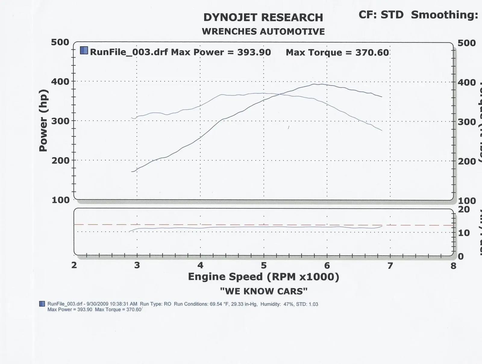

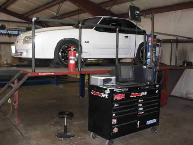

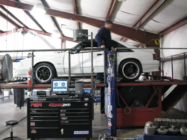

393hp and 370 tq its running pretty rich so hopefully ill get it rejetted soon and take it to the track
YouTube - lukes car 035
nice numbers, good looking car too. I love white cars with black or gunmetal wheels.
How come you didnt re-jet it on the dyno? how was the A/F and can you post a dyno sheet up?
Great numbers!:nice: couple more cubes than mine but basically the same setup, same heads similiar cam #s i have 10.7:1 compression everything else bout the same except im using a cobra intake i came out with 360RWHP and 383RWT mustang dyno. Not to start the mustang dyno dynojet pissing match just wondering what dyno?. Get ready to have some fun if thats your first car setup like this i still cant get the smile off my face everytime i take my car out (which is almost everyday if it aint rainin lol) too much fun!!!! GOOD LUCK
Thanks guys, it was a dynojet dyno.
The reason it didnt get rejetted was because i was only paying for 3 pulls to see where i was at and not to tune it. Ill try to ge the graph posted tonight. The afr was between 11.5-12.5
