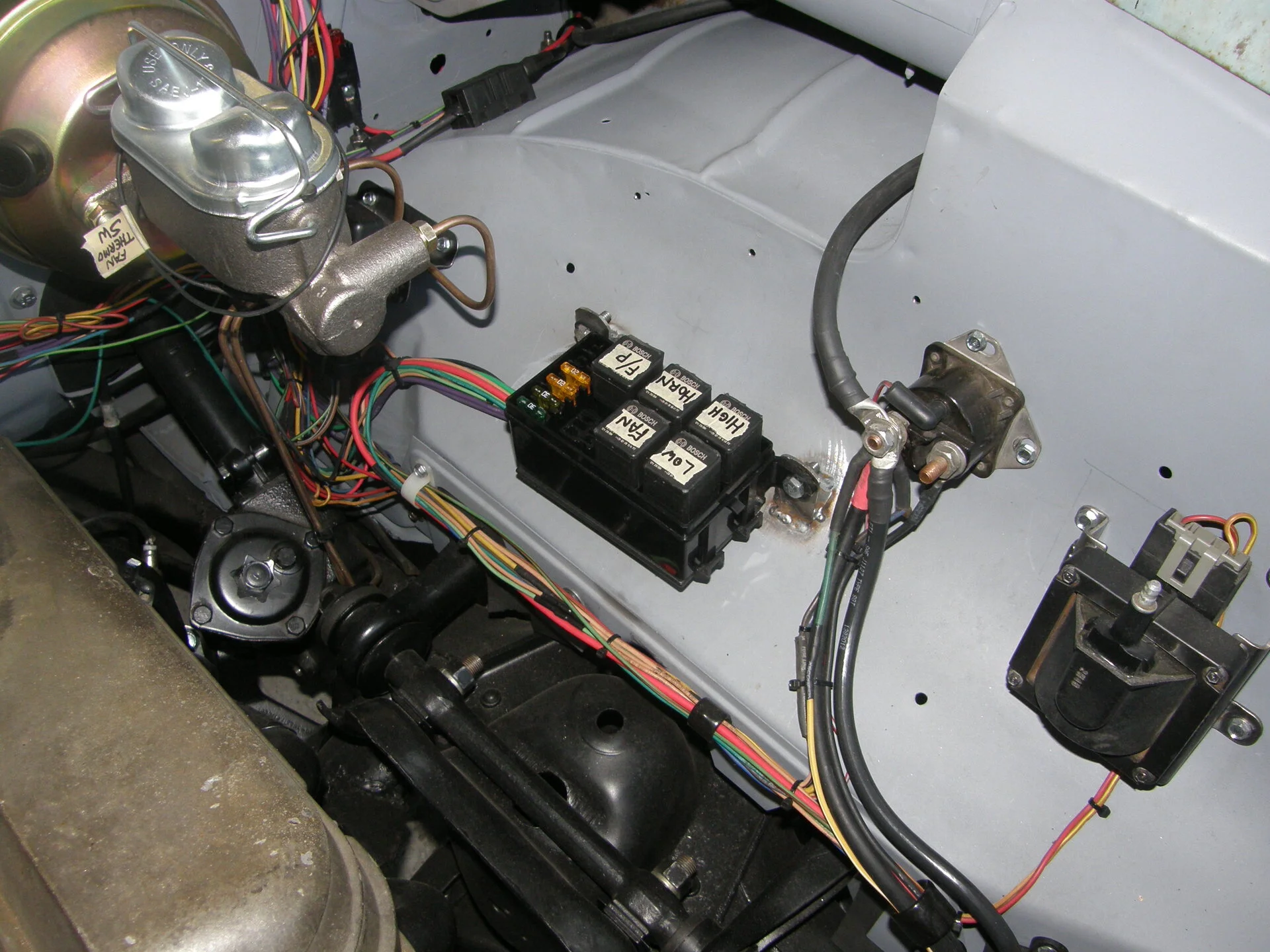

Can't you just do what the General said? Remove the nut from the solenoid and see what size it is. On my project I ran 2ga with ring terminals (I think the stud size is 3/8") from a power post to the solenoid 'cause the battery is in the trunk.

That's what I ended up doing. I guess I was just being an idiot and not thinking of that. It would fit a 5/16 but I ended up getting 3/8.
