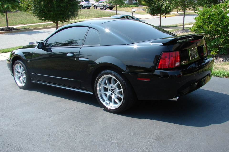

WOW!!!.... that looks great :nice:
Black car I detailed with a pc7424 the other day.....
