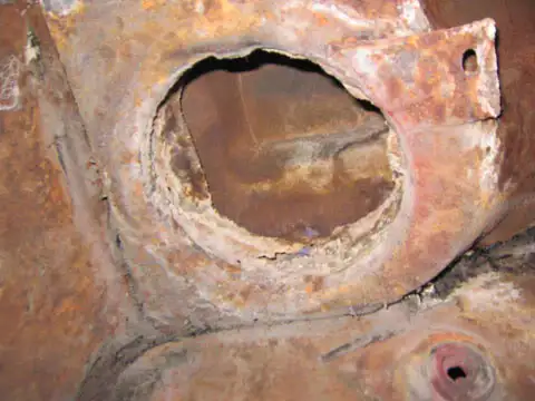

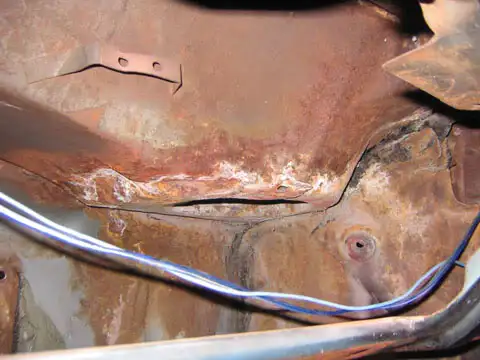

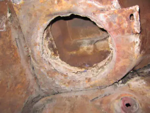

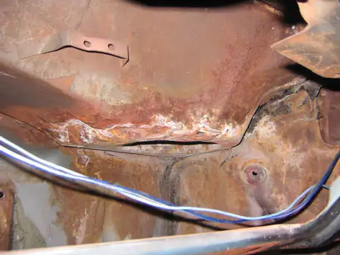

you are a lucky girl, seems that you dont have a big rust problem. for the first time since I have my car (about 6 months), today I take the ?heater? assy, and I find a unpleasant amount of rust down there :mad: . Im glad my summer vacations are just starting so I can have time to repair it.
Yeah, after finding all the rust in old Sadie and realizing I was in way over my head, I was specifically lookng for another mustang with as little rust as possible (within my budget). New Sadie only has about 4 or 5 rust problems which is pretty darn good for being in Missouri.
