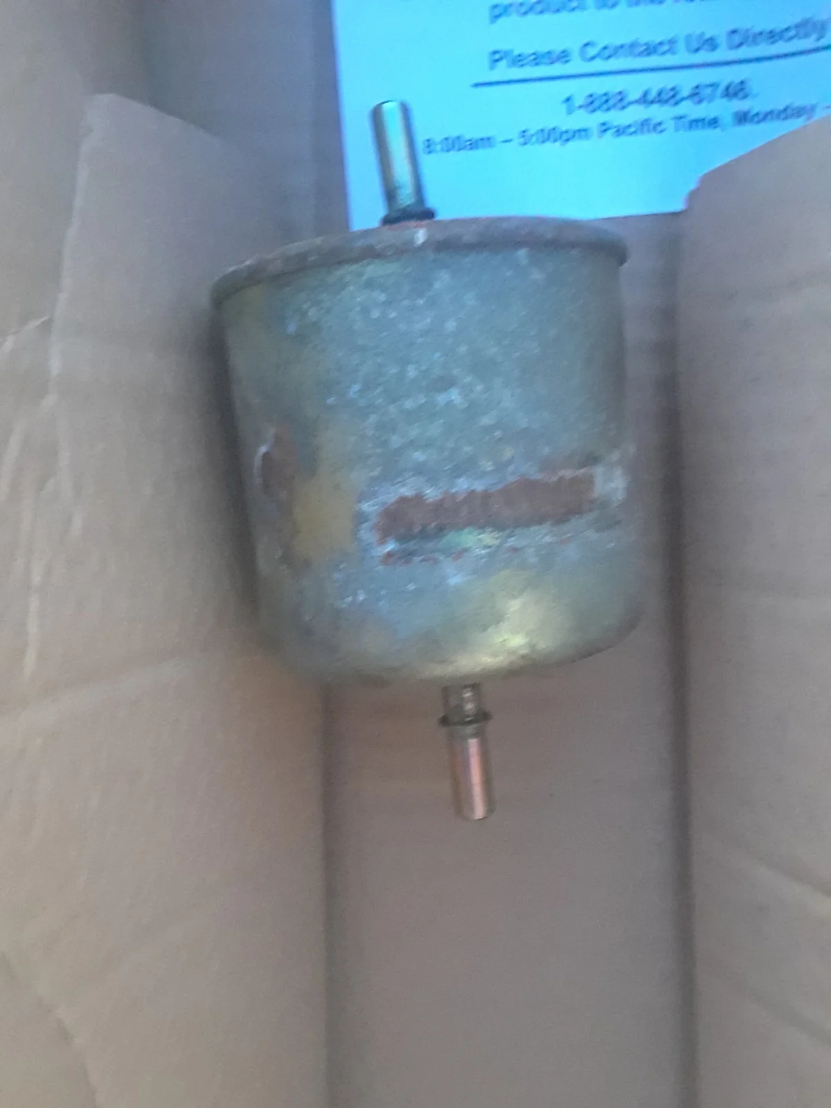

UPDATE: R&R'd external fuel filter. I think the last time this fuel filter was touched was in the assembly plant back in '92. The car easily feels 25-30% stronger. How can people not change a regular maintenance item like this? Take a look at this fossil!

That is exactly how the one on my 87 looked when I changed it in June or July after I bought the car in April of this year. Mine was a motor motorcraft and I too suspect it was the OEM filter. 32 yrs old!
Like you, it felt like my car picked up 30hp (lol) after I changed it with a new motorcraft filter. I literally could hardly blow any air through mine. It had to be nearly plugged. I'm surprised the car even ran and didn't burn up the fuel pump.

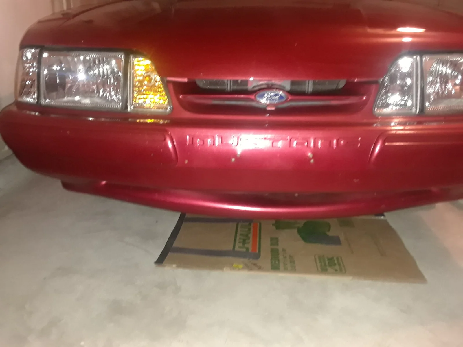

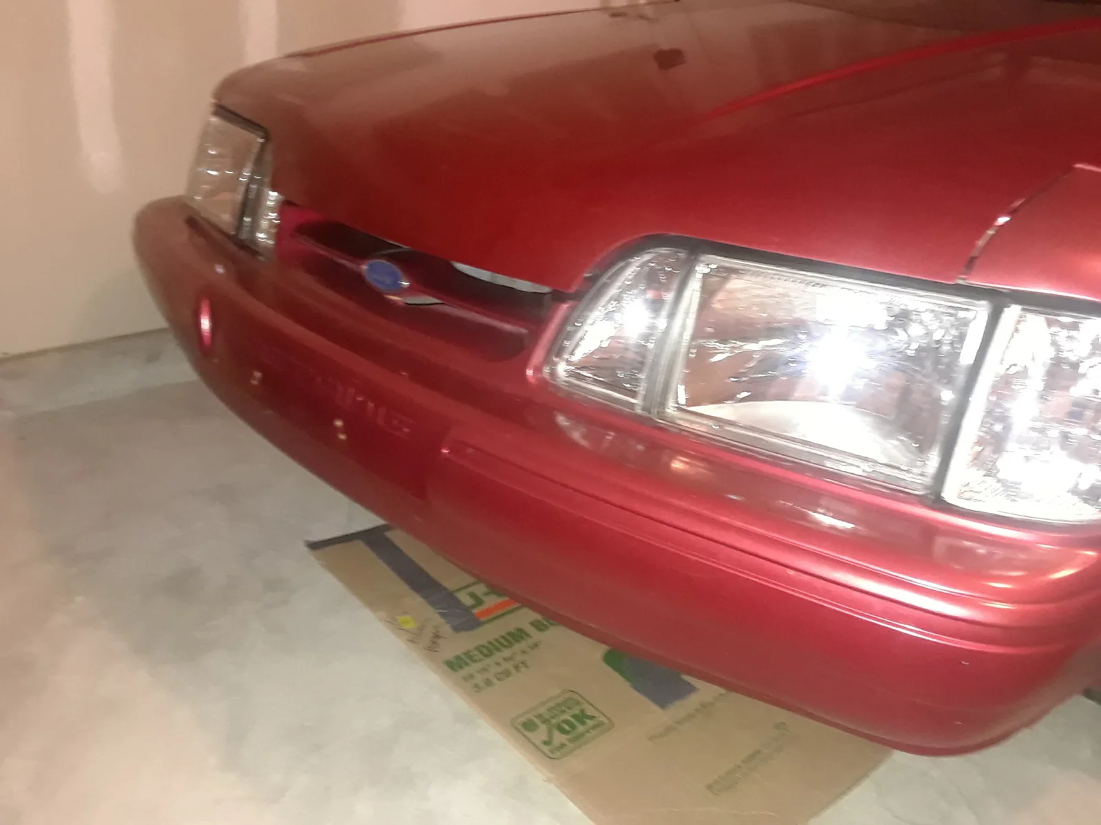

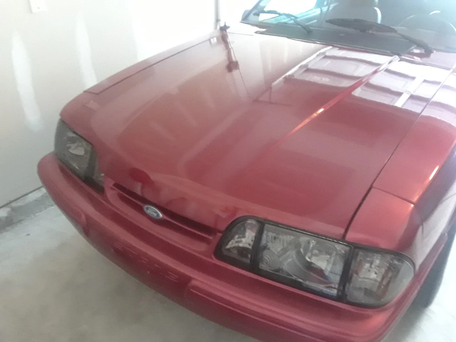

UPDATE:
Drum brakes should be coming next week. In the meantime I swapped out the headlights. In my opinion they look much better than the old ones. The reason for swapping is that the headlights seem to be dim at nighttime due to the smoked effect, and I don't see as well at night as I used to see. Check it out (before & after):
BEFORE
AFTER
Reactions: Gs1987GT, General karthief, RaggedGT and 1 other person

Look at that guys, he put oem style triple lights . Very nice car guy , and at least you own a fox people want . I like the front bumper its in good shape.
