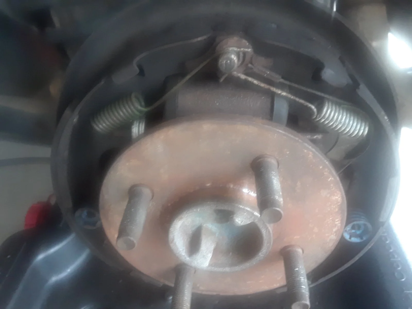

I did the dreaded drums, hardware, shoes, and cylinders on my car. Because I'm such a bonehead it took me 1 & 1/2 days. I was making a basic mistake not related to the actual brakes that made the job impossible to finish. Let's have some fun and see if anyone can guess what I did wrong.
The setting: Yesterday, I ended up doing the driver side set up six or seven times, so I know drum brakes like nobody's business now. I got the entire set up all complete except when I went to install the drum I couldn't turn it no matter what I did. I tried it with all new hardware, old hardware, and a combo of both, but couldn't get that drum to turn. I even checked the adjuster at the bottom several times and it was all the way closed. I checked the E-brake and it was all the way disengaged. Over and over I did and redid those rear brakes, but each time I couldn't turn the drums. They felt like the brakes and/or e-brake were grabbing.

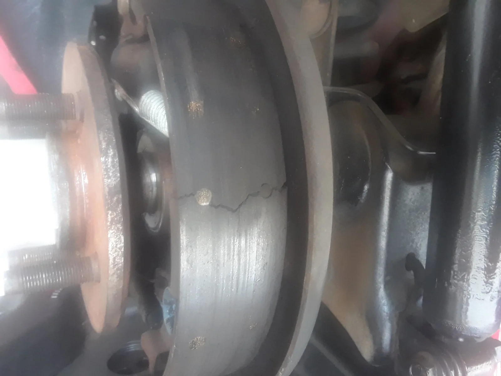

Here's a pic of the old shoes and why I wanted to R&R:
From the looks of things this might have been the second pair of shoes and hardware EVER on this 28 year old car:
