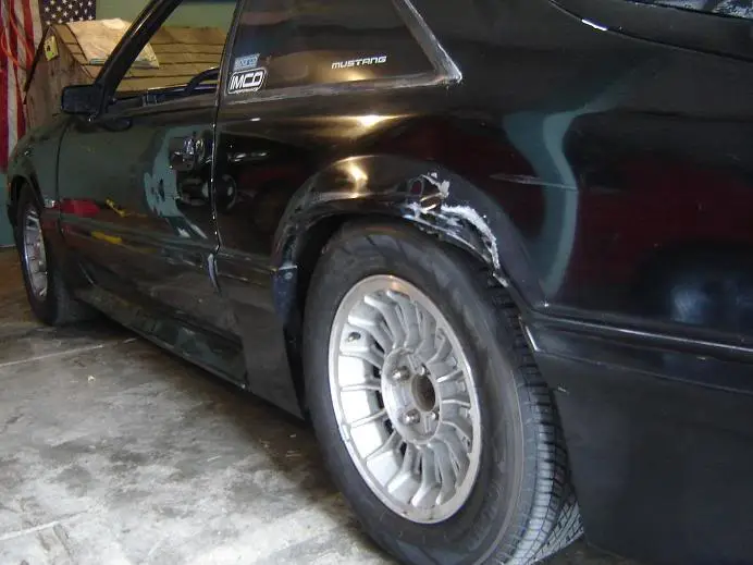

So today i got in an accident that crunched my driver quarter panel. I really didnt plan on doing any body work or painting the car for awhile but looking at that crunched quarter panel everyday irritates me. What would be the best way to repair this using the most inexpensive way and without yousing too much bondo. I would like to repair it now and primer over it so at least it looks decent but I dont want to put too much bondo on it so by the time I get it painted it is all cracked. There is a large bow in teh quarter that goes from the top of the wheel well to the crease that is a few inches below the window. The fender flares are also crunched in slightly.
What do you reccomend I do?

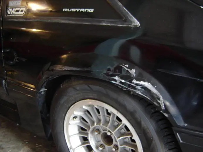

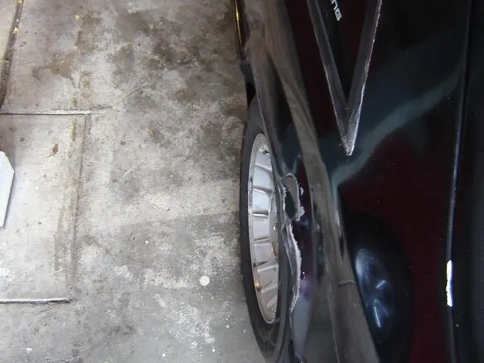

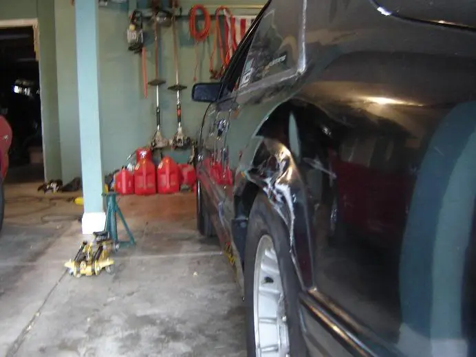

here are some pics. There is a large bow in the quarter from the top of the flare to right at that crease. Could I use one of those pullers to get that out? How do you think I should go about with the crunched flare?

Damn, it's hard to make anything out with that black paint. I'm not sure what you mean by the metal being double layered. I've never actually done a quarter on a Stang, but on my Probes all I did was grind away the paint, weld lots of studs on and slowly pull it out with a slide hammer while someone tapped on any crowns. I got it to about 1/8" of right in most places and Bondo did the rest. Good luck with it.

there is the body on the outside, and then there is teh wheel well that curves in. So when I try to bang from the inside it just hits the wheel well metal. it doubles up at the flare and then seperates, one for the body and one for the wheel well.
Does anyoen have experience with fiberglass filler? Whats the difference between that and bondo? I dont plan on painting it for awhile but i want to fix it now but dont want it to crack when I get it painted.
Guess you'll just have to pull on it then. From what I've been told, you use glass for larger areas to build support and go over that with plastic filler for a smooth surface. Glass with hairs in it isn't too easy to get as smooth as the plastic stuff.
Have you tried pulling the interior plastic off and pushing on it from there? Make body filler a last resort, if you don't do it perfectly, in time it will crack, and if you don't seal it very quickly it will absorb water.

No I have thought about it but I still dont think I will be able to get the the flare part, only the big bow part but I want to pull that out with the puller first. I also am trying not to put filler on. I may just try the best i can and leave it at that for now. Maybe work on it from time to time to try and get it close to perfect. But I really dont want to use filler.

I had almost the same happen to me, it was a pain to get that line around the lip of the fender right, but with a BFH and body working tools i got it about 1/4" to1/8" of perfect in 99% of the spots, also i used a "C" clamp and pulled up once clamped to get the bottom lip straight, then pounded on the upper part..also a screw type slide hammer is cheaper than the weld on pin type, just drill a small hole, screw it in and slam the handle back..you'll get it, just spent a few hours on it and you'll get it, a body shop would probably charge around 150-300 to get it straight and bondo it, repainting will cost a couple hundred more to match the factory color
