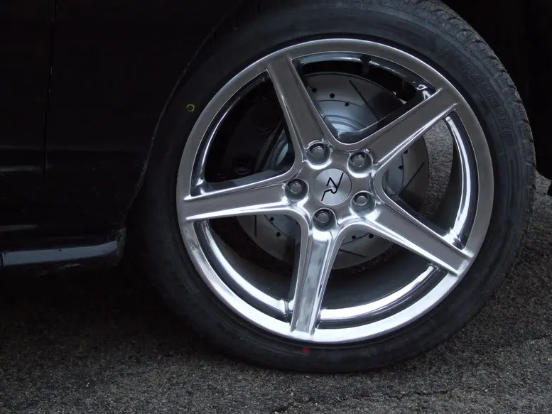

Sorry for the crappy quality pic.
Anyways I got them on, but when I spin my rim it makes a rubbing noise. Its the pad contacting the rotor, is this normal? I heard it was but that makes NO sence to me why it would rub, wouldnt you notice it on your car now or is it just because its brand new pads?
Thanks!! :nice:
Disc brake pads always rub a bit on the rotor. The caliper applies pressure when you press the brake pedal. When you release the pedal, you relieve the pressure, but there is no means to retract the caliper furthur than just relieving the pressure. The caliper continually moving out as the pads wear is how disc brakes are "self-adjusting".

Ok thanks Matt, thats what I thought it just seems that they rub fairly good, the wheel will do like a good 3 rotations tho once i getter goin.

heres a pic when its clean
