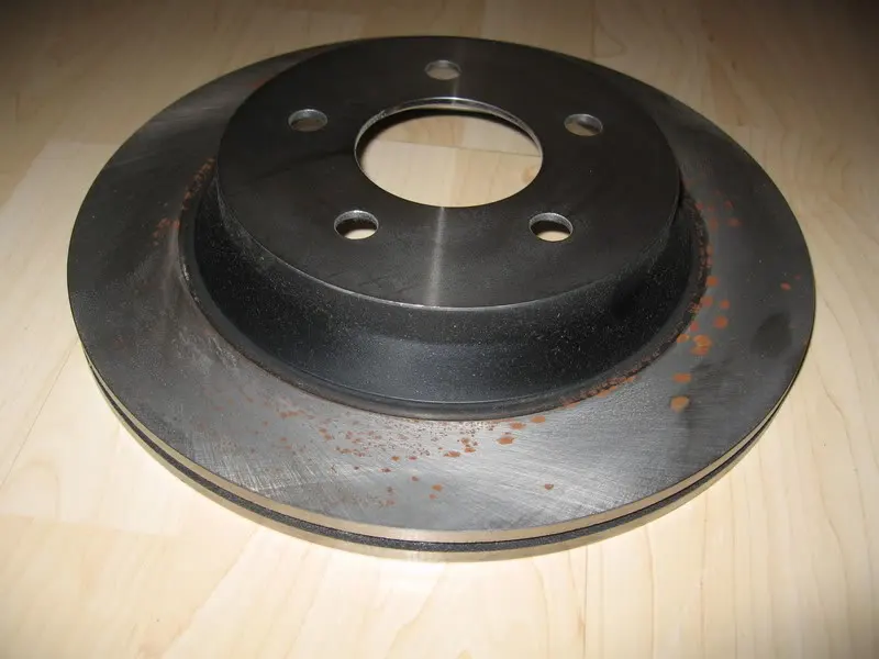

There was a slip of paper in the box that recommended painting the "hat" portion of the rotor with high temp paint to prevent corrosion I think.
What is the "hat" portion and should I paint it?
Wished I would have painted mine - the hat is the area from where the rotor meets the wheel over to where the caliper meets the rotor. All this area will quickly get surface rust growing on it...not pretty. See mine in the attached photo. Hard to really see, but it's the dark area behind the rim (you can also see the rusty color on the front edge). (Now you can probably understand why they call it a hat as it's hat shaped! :D ) Best of luck! PS - be sure to use liquid pipe thread (as opposed to teflon tape) to seal your lines. PS2 - make sure you have the proper flare wrench. :flag:
The "hat" is the black part on this rotor
I didn't paint mine though have such a dark thick coating of rust/brake dust it might as well be black paint. Even with my FR500s on I don't notice it, because the rust is so dark it gets lost in the shadows. I imagine it depends where you live, if you live in the rust belt and they are going to get dark thick rust I wouldn't bother. If you live somewhere warm and sunny where you'll get mild brown rust I'd do something about it.
