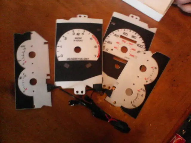

wow these things are nice!
a few questions i have though, there insturction sucks on what to wire to what?
pics of the gauges!
anybody know what i need to do?

sorry, I have no idea...but they look pretty good! I want a gauge that doesn't "yellow line" @ 5,000.
i drought you will find any overlays like that. these are really nice though! im glad mustang5L posted about these in a thread! or else i would of made the mistake of buying the cheap vinyl overlays.
these are much better imo! only thing is...wiring owns me :(
They have their own dimmer right?
All you need is a hot wire and a ground. Black gets grounded the red connects to a wire that comes on with the interior lights.

ya its a 88. and it has a little selector almost like an on/off....on the site it said either a blue or green back light color so maybe that's the selector..
that's what i thought, power and a ground...is it ok if i just ground it to the metal frame for the dash?

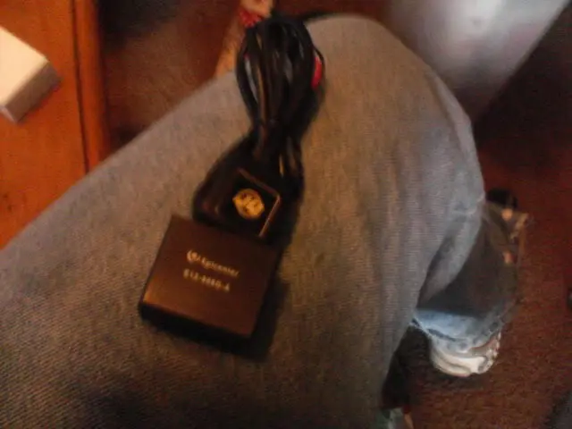

i have the same ones in my car you can ground them to the metal in the dash thats what i did! ive had no problems! did it come with the little pad to change them different colours? if so youll like it its cool! from green to purple to blue! you can also fade out the gauges and just light up all the neddles! James

sweet man! you got any pics of them instaled? im not putting mine in till tomm night/morning....i dont know where i wanna mount that switch at?
mine is a 91 and i mounted the little pad just under the dimmer switch between where the 2 plastic parts of the dash meet ! it makes it kinda hidin! i dont have any pics of the install! it was done before i had a digital cam!! back in the dark ages!! lol they will look get though! i put that litlle back box thingy under the dash by the hood opener! just made all the wire neat and zipp tied them to keep them from hanging and getting in the way! good luck with the install ! James
