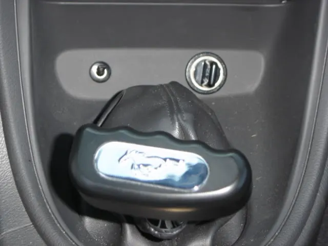

Here is where I mounted mine...
And of course a few burnout pics!

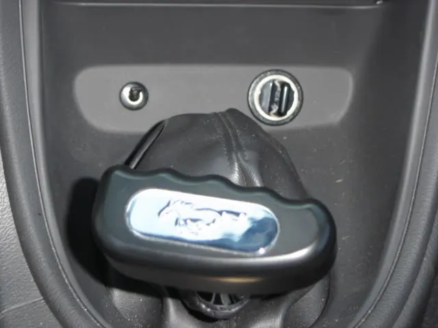

Here's what the keylock switch looks like now. I added a black fibre washer for looks. It's a little better. More OEM-like.
I also have the keylock switch wired in now. I soldered two 2-foot wires to the keylock switch and added male and female spade connectors. That way, it plugs right into the SLP switch without cutting anything I can remove the key and stick it in my pocket for safety.

Looks great!! Where did you get all the necessary parts for the keylock?
With the SLP switch do you have to hold the switch or do you just flip it to one side and it keeps anymore brake fluid from goign to the front and when you're done you just flip it back?
Thanks :)
Thanks :)
The keylock switch was from BG Micro. Search www.bgmicro.com for item SWT1083.
