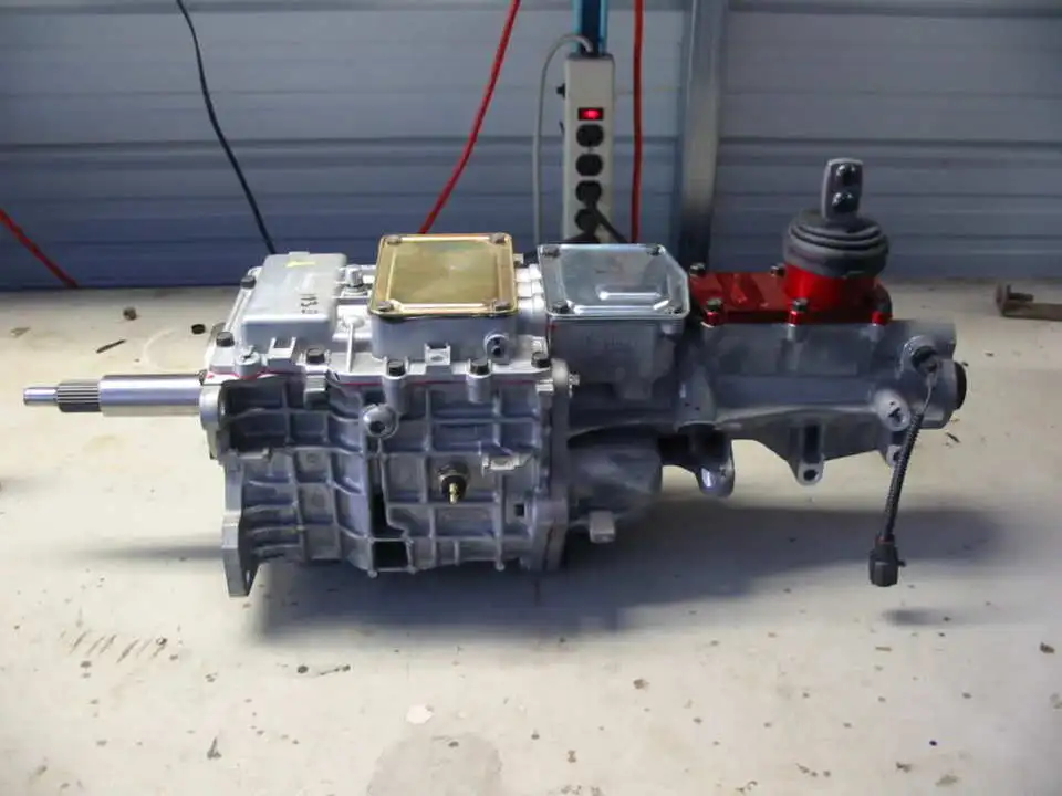

Anything I should check out on it? I spun the input shaft and tried to run it through the gears like the instructions said too, there is a plug in the tailshaft though making it hard to turn though.

Wish i could afford to get one of those. Tht plug is just there untill install to keep trash out right?

Looks it yeah.

Looks brand new to me. Nice score!

It is, I bought it from D&D.

$2,204 in so far. D&D is running a free shipping special which is why I jumped on it a littler earlier then I originally planned. Still need a clutch, and I want to put a Quicktime bell on the car too.

Everybody keeps asking me why I went with a TKO instead of a T56. I didn't want the extra weight, the cost, and since I run 3.55's, I figured I didn't need the extra gear.

You'll like it. I have MMR's modified TKO500 and it's very nice. Just make sure you check your pinion angle after you install it. The TKO's are known to cause high speed vibrations if the pinion is off just a tiny bit.
