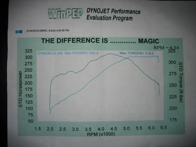

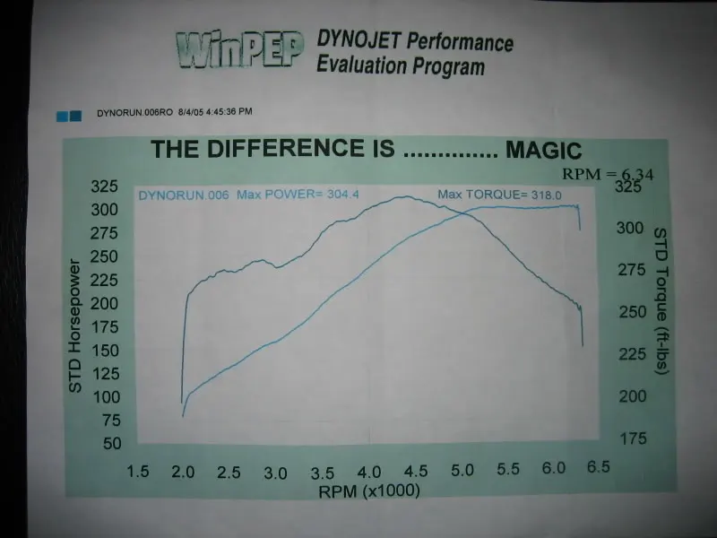

this was all i got printed out, i will get more print outs when i go back to have the throttle body installed. so the results are pretty good? what would the approx numbers be at the crank?

Well, I don't want to comment too much on it, as Joe is one of my competitors here on Long Island and it wouldn't be right. The power looks good for the mods. Should be in the high 290s with the SAE correction. STD numbers will read higher as they are corrected to a more optimum air correction.
Ask for SAE numbers next time and get them to add the A/F at the bottom of the graph.
