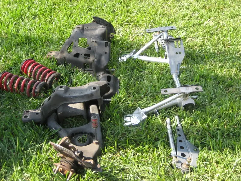

I Gotta give Credit where credit is due....Apart from having great pruducts becuase GRIGGS have great suspension products.:nice: The Customer service is excellent:hail2: Check out my new set up of Severe Duty A-arms and K member they were able to repair the K member that I bought off ebay..I cant say enough. I even spoke to John Grigg for advice on my setup...

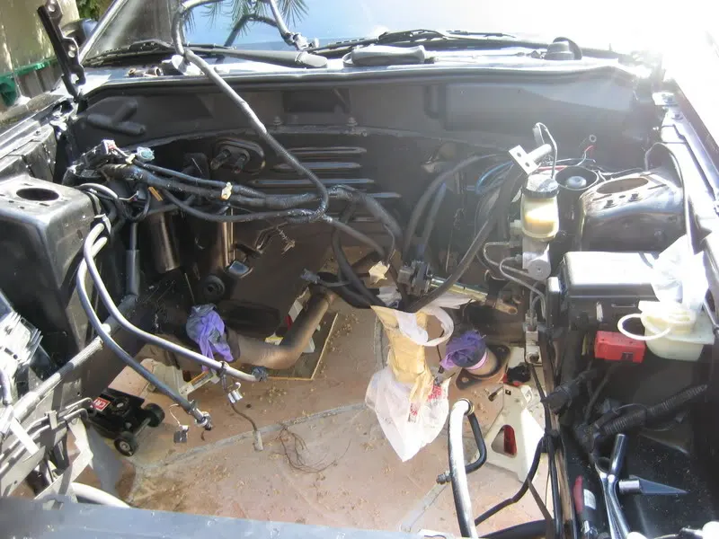

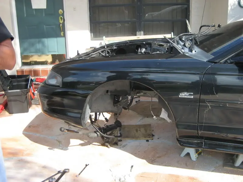

:OT: Well here I am after a long road off getting all the right parts I am coming back together...... Its been A VERY LONG ROAD:nonono: I have had problem and been short on parts and back orders and the problems go on and on. But now I am coming back together hopefully trouble free.....:flag:

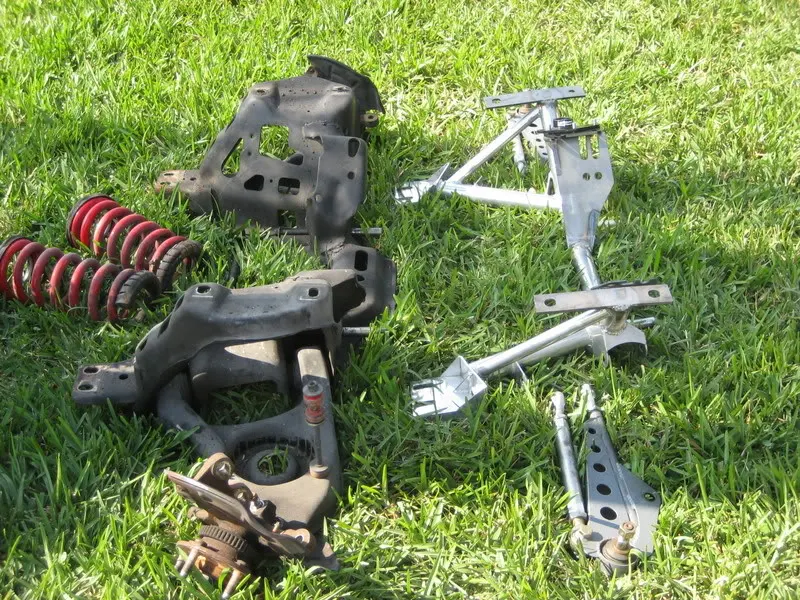

:dead: The K-Member swap is soooo worth the money and trouble...check out the stocker next to the GRIGGS piece...the stocke is as heavy as it looks.:jaw:

Thats the one thing I regret not getting when my motor was pulled. Looks like you got a lot of work ahead of you. Good luck.
That is the reason I did wait a little longer to throw the motor in and get the Griggs K member everybody says the same thing.....And with good reason too it cleans thins up and lightens the front end by what i would guess is about 75 lbs.:nice:

Why Gratenelli coilovers? I would use the Griggs and run their springs. They are the way to go. More money though but worth it. Then you can talk to them about what spring rate you want, and you can always change it. They have many to choose from.

It doesnt take very long really maybe a couple hours without the motor installed. with it installed maybe a little longer sonce you have to hoist the motor upand hold it up there securely.
You can order it with or without the motor mount plates. Although mine came without it cuz the guy I bought it from gave me a good old fashion scr@wing. He even sold it to me as a 94 when it was actually a 93 anyways. I am actually glad it happened becuase after i sent it to the griggs shop it came back as a very nice product....as for setting the motor back I really dont think so plus it has a bit of adjustment.....
