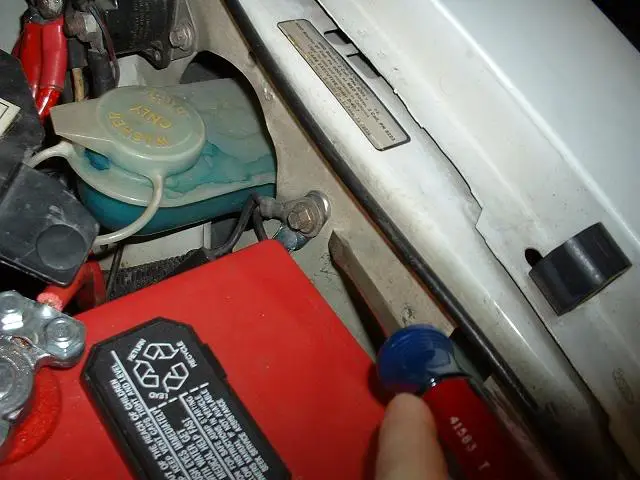

For a car with a 3G alternator, I recommend a 4 gauge cable run from the same spot as the engine to battery ground to the common ground point near the windshield washer filler neck.
The battery common ground is a 10 gauge pigtail with the computer ground attached to it.
Picture courtesy timewarped1972
Correct negative battery ground cable.
