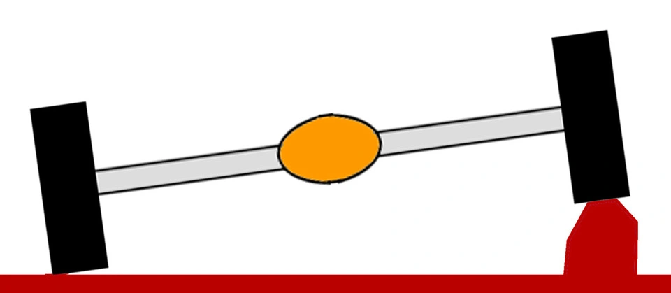

calboss281 said:
As I said before, the IRS only assists the driver, it doesn't make the car perform better. The ENGINE makes the car perform better, the ford racing bushings, springs, control arms, and sway bars....THOSE help the car perform better. The IRS just helps the driver maintain control and stability of power distribution during turns. The live axle does this as well, just not as efficiently. The live axle uses a limited slip to perform a similar action to the IRS (shifting power to outside wheel), but the IRS does it more effective because it doesn't need a clutch to transfer the power to one side.
The IRS advantage goes a little deeper than just that.
The main advantage of the IRS is the ability to keep a full contact patch with "both tires" on all road surfaces and grades. When the road surface is uneven or not completely linear, one wheel retains a full contact patch, while the other runs on the inner or outer edge on a solid axle car.
An IRS car however will be able to maintain full contact patch with both wheels, since each wheel is situated and controlled independently from the other.
An exaggerated demonstration....
Solid Axle
Independent Rear Suspension
Not only does the contact area of the tires remain constant, but the suspension center and as a result vehicle centerline remains more horizontal as well. This limits body roll and unwanted weigh shift. Thus improving handling over all capability.
Solid Axle
Yuppers! Seems logical doesn't it? No wonder performance car makers outside of the US rarely use anything but IRS. Nice pictures.
Which is pretty much irrelevant unless your driving abilities push the car to the limit where this advantage is actually necessary. Like I said, I've seen GTs blow away vettes just by driving ability. Things always sound great in theory, but it's really all about practice.
