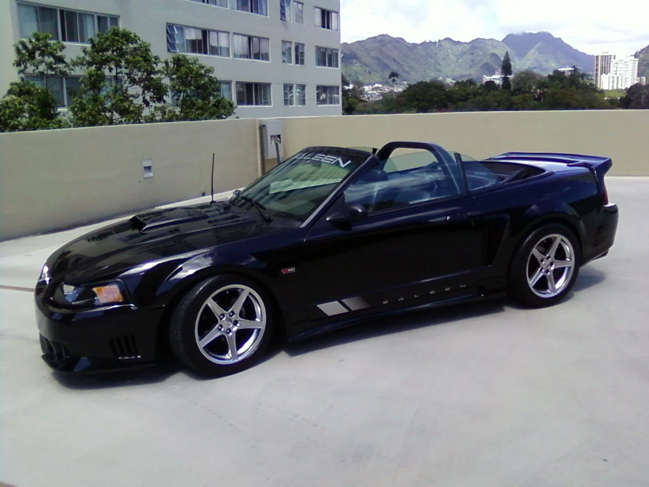

Hi guys - I am new to the forum.
I have an automatic 4 speed 2002 GT convertible, w/full Saleen bodykit, light bar, suspension/sway bar and twin flowmaster 'airboat' exhaust w/magnaflow tips - I am about to supercharge it:
- series iv charger
- lighting force front heat exchanger
- chicane inter-cooler
- JLT cold air intake
- lightning force super-charger coolant tank
- 42 lbs ford racing/bosch injectors
- everything else related to the charger (intake manifold, etc.) saleen
it is a stock GT engine, and have had many opinions and thoughts on max horsepower/boost that is safe for the engine, given that 'safe' is a relative concept - I have heard everything from 'don't worry about it if you don't redline it' to 'keep it at 350 rwhp to 375 rhwp' - supposedly the charger can make more horsies than is safe for the engine, and I don't particularly care to spend the coin beefing up the engine - it is running great w/ only 29k miles; in terms of boost I have heard a range of 5-6 to 7-9 as 'safe' - I have talked to many pros at saleen, stage 3 motorsports, lightning force, chicane, tork tech, etc.
yeah, I am having pros install it and tune it - they say it can be a 12 second car if we tune it right...on to the 'safe rwhp ?'...
any comments or opinions on this?
thanks alot........rrrrrrmmmmmm.......

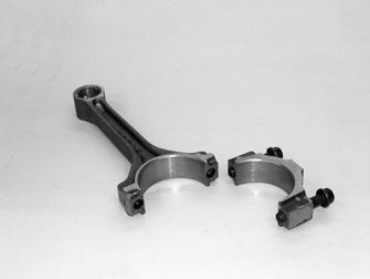

I would begin to worry at 400 or more rear wheel HP on a manual car. With an estimated 15% power loss, this translates to about 460HP at the crankshaft. I'm at ~390 or 448HP and that's plenty for me. Even then I still worry once in a while. All of that power is going through eight of these things:

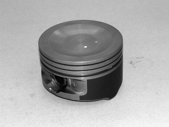

In addition, the pistons are cast hypereutectics with thin upper ring lands:
Check out how thin the band of material is above the upper ring land: Imagine how quickly it could be broken by detonation...
Keeping the tune conservative and the boost moderate to keep power output below a reasonable limit is the only way to be sure you won't hurt anything (and even then, by definition, you're going to be that much closer to the edge no matter what...)
